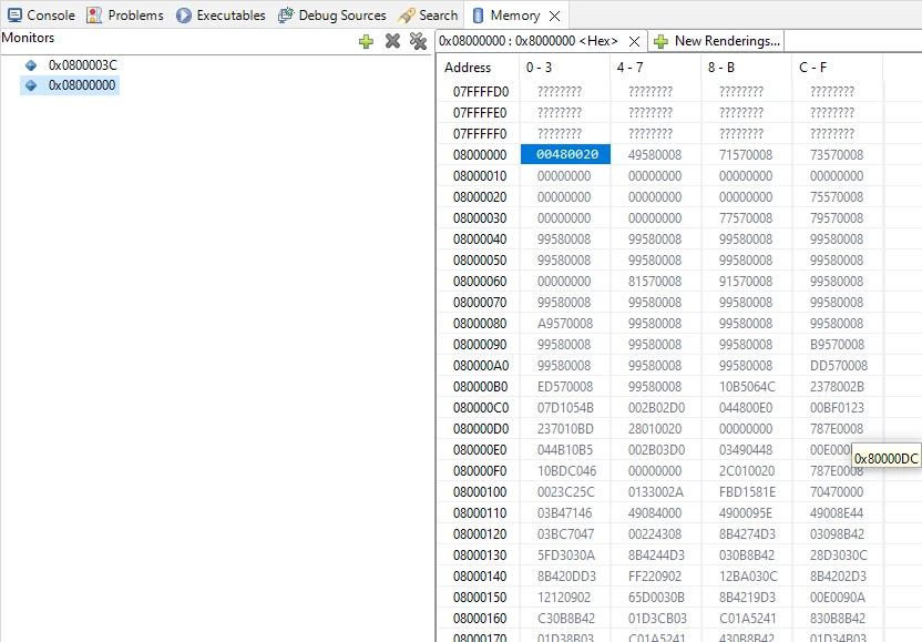

What does the debugger say, stopping at beginning of main(), in processor registers window, what is in SP (=R13)?
What is content of 0x0800'0000?

Jul 19, 2022 2:05 PM UTC
I do not see the line "stopping at beginning of main()" But that is what the debugger does. It stops at the beginning of main and waits for a command to resume or single step or whatever you want.

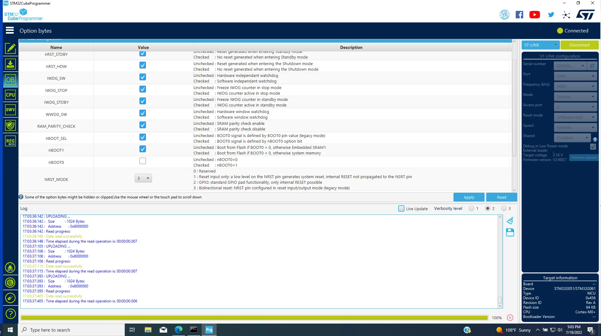

Tip: On devices with nSWBOOT0 or nBOOT_SEL option bit (STM32WB, STM32L4, STM32G0) it is possible to force boot from Main flash by using nBOOT0 option bit instead of BOOT0 pin.
This can be achieved by following Option byte configuration
nSWBOOT0 or nBOOT_SEL = 1 (BOOT0 signal is defined by nBOOT0 option bit)
nBOOT0 = 1
KiptonM
KiptonMAuthor
Senior III
Jul 19, 2022 10:09 PM UTC
It looks like
nBOOT_SEL was checked which meant BOOT0 signal is defined by the nBOOT0 option bit"
nBOOT1 was checked which meant Boot from Flash if nBOOT0 = 0, otherwise from system memory
nBOOT0 was checked nBOOT0 = 1
This caused it ti boot from system memory.,
I changed nBOOT0 to unchecked where nBOOT0 = 0
So that should have fixed it and cause it to boot from Flash. I am still having the same problem.
