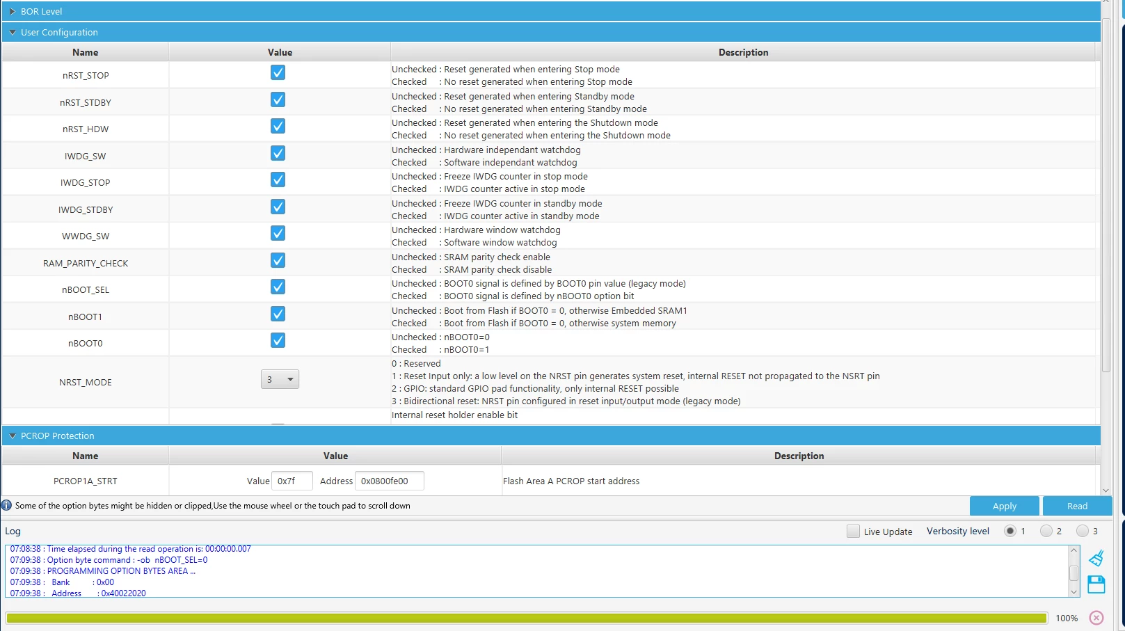

Did ST break SysTick in the last update? It used to work. Now it crashes because I think the interrupt vector is not set. Is this one of those known errors? How do I fix it?
When the SysTick interrupt fires the debugger quits.
I cannot figure out where the NVIC_SetVector statement is for the SysTick. I think it is not set. But I can not find the vector table in the debugger to know for sure.
This used to work, But when I updated to the 1.10.1 IDE and 6.6.1-RC2 Build.20220706-1420. It crashes when the systick interrupt happens.
I am using the STM32G051K8T

That CubeProgrammer description of nBOOT0 and nBOOT1 options is a nonsense. Again a blind trust without checking the real thing - reference manual...
Look at the RM0444 Rev 5, 2.5 Boot configuration, Table 8. Boot modes.

Could it be it booted into the system because I am running the debugger?

Thanks for the pointer. And yes I should be wary of ST software.
Looking at Table 8 the 4th line is a way to get to Main Flash Memory.
nBOOT_SEL bit needs to be 1
nBOOT0 bit needs to be 1
nBOOT1 bit does not matter
BOOT0 pin does not matter.
I thought that is what I started with before I started changing the fuses!
0693W00000QLd1JQAT.pngIt must not have been, because the PC Changed and the test code works.

And it works on my code with all the setup files commented out
And it works on my full code.
Thanks everyone for the help. This one is solved.

I also have to thank KnarfB for the pointer to the fuses. I have no idea how they got changed. I had to load the programmer into my computer to change them. I looked at fuses a long time ago, but have not changed them in a long time.
