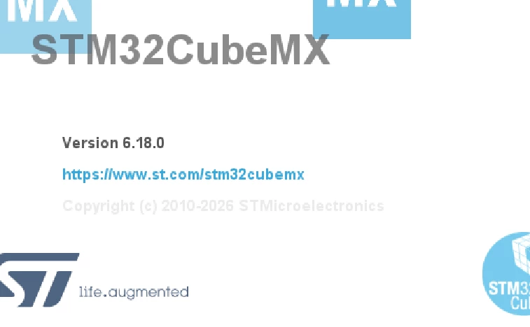

STM32CubeMX clock validation regression: STM32H743VIHx VOS0 LDO HCLK 240 MHz incorrectly limited to 225 MHz
MCU: STM32H743VIHx / STM32H743VIH
Power: PWR_LDO_SUPPLY
Voltage scale: Power Regulator Voltage Scale 0 / VOS0
Clock setting:
SYSCLK = 480 MHz
D1CPRE = /1
HPRE = /2
HCLK = 240 MHz
D2PPRE/D3PPRE = /2, PCLK = 120 MHz
Actual result:
STM32CubeMX marks HCLK 240 MHz as error:
"240 MHz max frequency must be <= 225 MHz"
Expected result:
According to STM32H743 datasheet, with VOS0 and LDO enabled,
fCPU max is 480 MHz and fHCLK max is 240 MHz.
This configuration was accepted before updating STM32CubeMX / STM32H7 MCU package.
