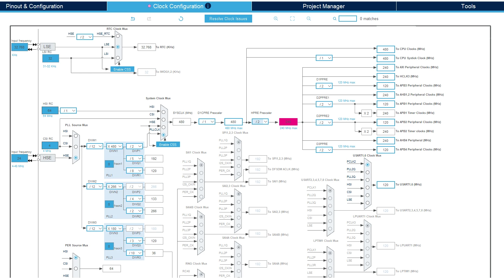

CubeMX Version 6.18.0 introcudes wrong check of clock limits for STM32H753

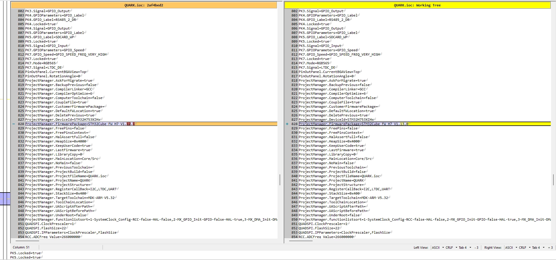

After I updated to CubeMX Version 6.18.0 (and newer CPU firmware pack 1.13 but this one not related to issue) I opened my older project and migrated to newer version. As a result I got error on Clock Configuration Page (see pic.1).
pic.1

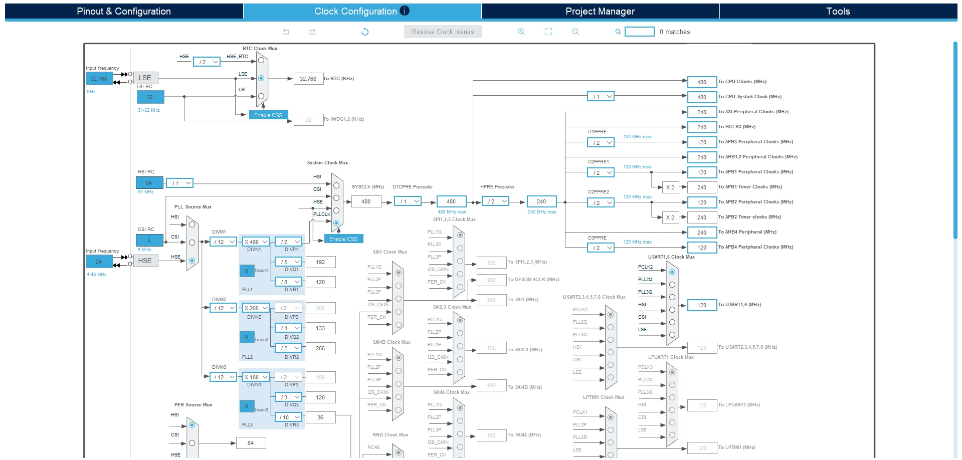

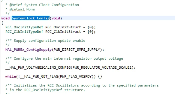

I saved project and checked if anything changed... I did not hound any changed, but versions (see pics. 2 and 3)
pic.2
pic.3

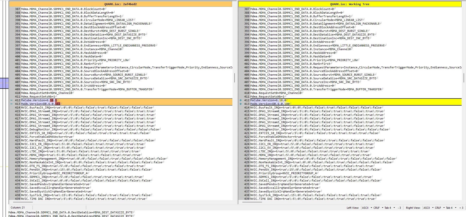

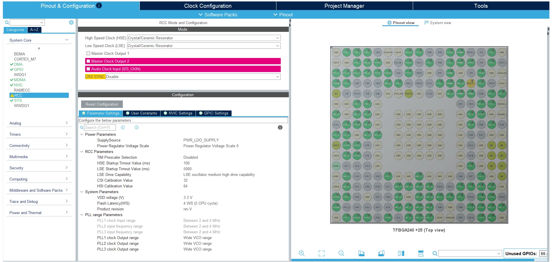

So, I downloaded older version 6.17.0 and there is no such issue. See pic.4 and pic.5 shows RCC block config.
pic.4
pic.5 RCC block config

Hello all,
in order to avoid the clock error above can you please try this workaround as follow:
Set SYSCLK to 150 MHz, and go to RCC configuration and select "Power Regulator Voltage Scale 0". Then return to Clock configuration and set SYSCLK to 480 MHz
BR, Souhaib

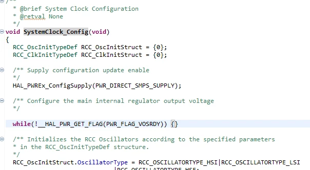

Jul 7, 2026 7:07 AM UTC
I have a similar issue on STM32H745, I kept the .ioc unchanged but after generating with 6.18 one line is missing

RostyslavAuthor
Jul 10, 2026 2:51 PM UTC
That worked for me. Migrated to 4.18.0. Thank you.
P.S.: Though had to manually reapply most of multipliers and dividers to values I had. Not a pleasant process :)
