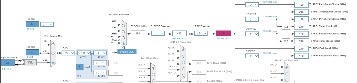

I wish to report what I believe to be a bug in the new version of CubeMX (6.18.0).
When configuring an STM32H743IIT6, I encounter an error in the Clock Configuration view (please refer to the attached screenshot). The same procedure carried out with CubeMX 6.17.0 works correctly.
I have therefore reverted to CubeMX 6.17.0, which is not a critical issue for me, but I thought it important to bring this to your attention.

Jul 3, 2026 11:22 AM UTC
Hello ​@DADD
Let me thank you for posting.
I suggest that you take a look at this post:
CubeMX Version 6.18.0 introcudes wrong check of clock limits for STM32H753 | Community
The issue has been already reported to the dedicated team (Internal Ticket number: CDM0064049).
I will keep you up to date until the issue is fixed.
Thanks.
Mahmoud

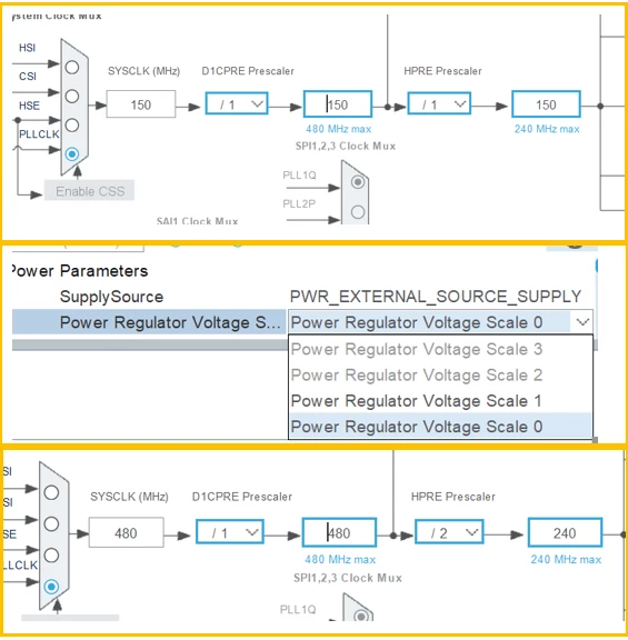

Jul 20, 2026 9:18 AM UTC
Hello ​@Mahmoud Ben Romdhane ,
Is there any update regarding this ticket? Please let us know if there is any workaround to resolve this issue with new CubeMX version 6.18.0.
Regards,
Neel
Jul 20, 2026 10:12 AM UTC
Hello ​@Neel.SE
In order to avoid the clock error above, I recommend that you try this workaround as follow:
Set SYSCLK to 150 MHz, and go to RCC configuration and select "Power Regulator Voltage Scale 0". Then return to Clock configuration and set SYSCLK to 480 MHz
I will be waiting for your feedback.
Thanks.
Mahmoud
