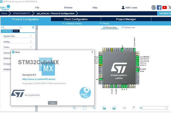

Semer CHERNI
October 3, 2024
Hello
I want to share the info that the installer for macOS is now available on st.com.

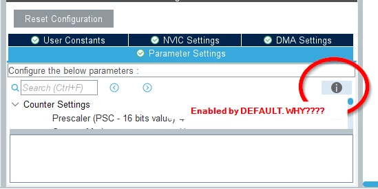

Visitor II
October 4, 2024
I don't know if this happened with v6.12 or 6.12.1, but there has been an annoying, no reason for this to change done to the UI. For the Parameter Settings tab the "Show/Hide description area" is enabled by default. If you turn it off and then go to another peripheral, and then back to the one you were originally looking at, it's back on! STM32CubeMX.png
Why was this done, and why is there no way to turn off this obnoxious behavior, and who thought this was a good idea?

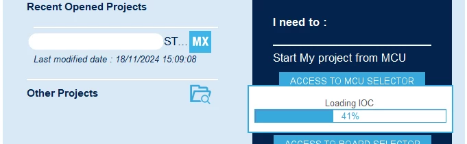

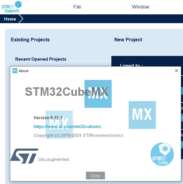

November 18, 2024
What happened with CubeMX 6.12.1? It's empty... I tried to open my .ioc one time and nothing. So I tried to create the new one - nothing (I do some operations then it's even do not open throw the CubeMX). How to understand it and what to do? Which version is stable and I can use without bugs?
Windows 10 Enterprise 22H2 x64. I installed to new PC, tried to open old projects, tried to merge it, tried to create the new one. I saved .ioc to the old project it's worked. It happened throw the time. In general, such a simple application for some reason overloads the system or simply glitches on its own.
LLeva.1
November 18, 2024
Looks like some local problems. Mine starts ok.
November 18, 2024
Strange situation that I created the new one. Worked with it and in the one time didn't open any menu as GPIO or System - no one.
Then I closed, open again - tried to open
loading and then nothing

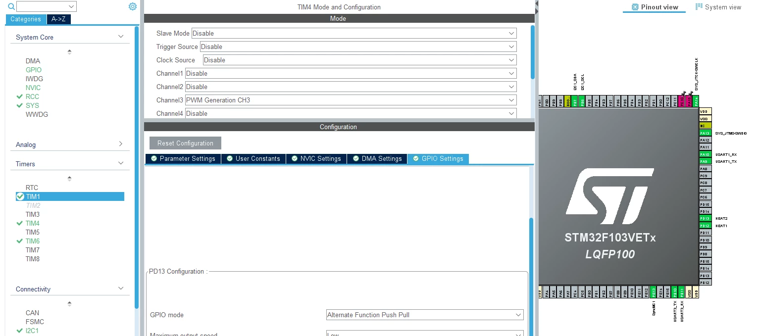

I thought that I found the problem in my case, but I was in a rush... I installed JDK/JRE.. something changed but it's at the feelings level.
I starting new project than set some settings like system, timers, connectivity etc. Then I starting to set pins and... look at the picture. The cursor push TIM1 and nothing changes in the right window. In this point CubeMX do not work at all.
I tried this operation several times and result the same - CubeMX breaks own work day. And my heart too... I reinstalled the CubeMX too - nothing.
Mb problems in some driver or something else. It could be because my PC is a new one. Mb some settings... Mb... Mb... But how it works with another users and don't works with me I don't know.
