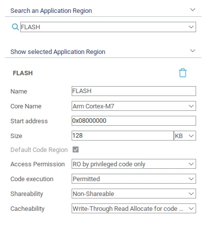

The correct action is to select FLASH (or RAM) in "Search an Application Region" :
Then save and re-generate project.

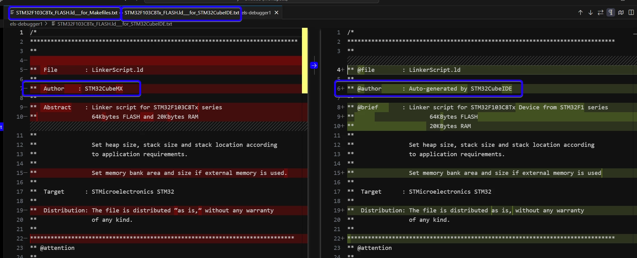

Well, this is not the solution either. In my case, for STM32F103C8Tx, CubeMX does not allow configuring it's memories (under tools).
CubeMX produces an .ld file completely different when exporting for Makefiles and exporting with build files for STM32CubeIDE. Strangely, the .ld file produced for using with STM32CubeIDE reports it is generated by STM32CubeIDE and not by MX.
FYI, I am attaching the two different linker files
