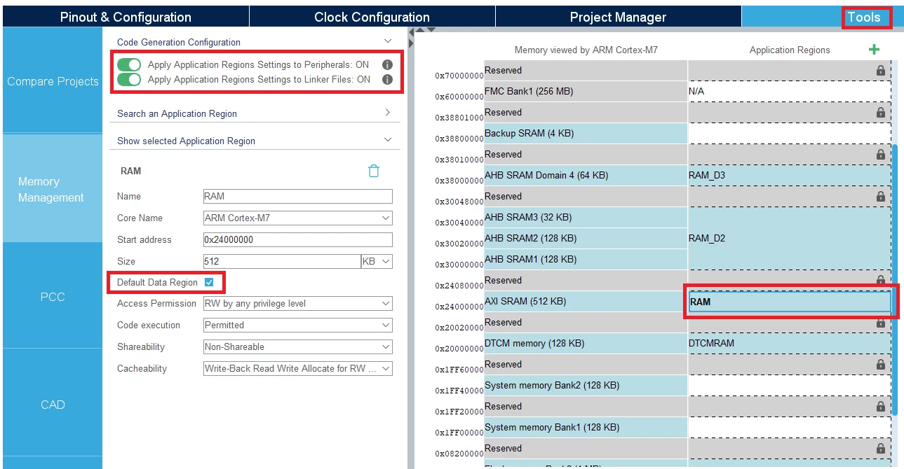

Since the latest release of CubeMX (6.12.1), I have been encountering syntax errors related to the "FLASH.ld" file. This issue only arises when I generate code while setting the Toolchain/IDE to CMake. I am using STM32H753IIKx. It seems that CubeMX does not specify which RAM to use when setting the Toolchain/IDE to CMake.
I have also included the FLASH.ld file that was generated for your reference.
Thanks for your help.

Hello @OmidES
Issue has been solved on the STM32CubeMX V6.13.0.

OmidESAuthor
Dec 3, 2024 8:01 AM UTC
I still get the same error even with STM32CubeMX V6.13.0.
Thanks
STTwo-32
Dec 3, 2024 8:12 AM UTC
Have you created a new project from the beginning? Please try this.
Best Regards.
STTwo-32

Issue has been fixed after creating NEW project from the beggining

Dec 3, 2024 9:05 AM UTC
Hello @OmidES @streb2001 @RichardS1 @LPetr.1 @luoqi
It seems to be solved on my side. I've migrated the file shared by the @OmidES (the one using the STM32CubeMX VB6.12.1) and it seems to be working fine.
Best Regards.

Graduate II
Dec 3, 2024 10:07 AM UTC
If it compiles but chooses the wrong RAM then surely it is not fixed?
OmidESAuthor
Dec 3, 2024 12:27 PM UTC
Hard to say. In my case, DTCMRAM is not the right RAM for my application.
OmidESAuthor
Dec 3, 2024 2:00 PM UTC
I think I found a solution to also choose the desired RAM in CubeMX. This has been added in CubeMX v6.13.
To do this, navigate to Tools > Memory Management, where you can select the type of RAM you want to use.
Make sure to enable the following options:
- "Apply Application Regions to Peripherals"
- "Apply Application Regions to Linker Files"
- and check the "Default Data Region" box.
Also, ensure that you delete the existing .ld file in your project folder. Otherwise, the .ld file will not be updated.
I have highlighted the important steps for your attention in the figure below:
