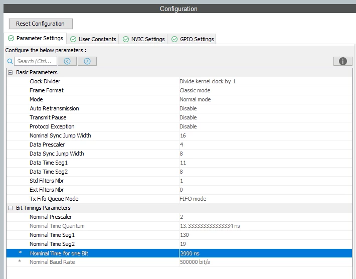

I'm trying to attempt CAN on a STM32G473 MCU. While transmission seems to be fine, I'm not receiving any data back. The receive call back function is not triggering.
Following is my setup:
_legacyfs_online_stmicro_images_0693W00000bjJuuQAE.pngBelow is the TxHeader and RxHeader initialization along with the call back function. I have a breakpoint in the call-back function which never gets triggered.

My MX_FDCAN_Init() function :
static void MX_FDCAN1_Init(void)
 /* USER CODE BEGIN FDCAN1_Init 0 */
 /* USER CODE END FDCAN1_Init 0 */
 /* USER CODE BEGIN FDCAN1_Init 1 */
 /* USER CODE END FDCAN1_Init 1 */
 hfdcan1.Instance = FDCAN1;
 hfdcan1.Init.ClockDivider = FDCAN_CLOCK_DIV1;
 hfdcan1.Init.FrameFormat = FDCAN_FRAME_CLASSIC;
 hfdcan1.Init.Mode = FDCAN_MODE_NORMAL;
 hfdcan1.Init.AutoRetransmission = DISABLE;
 hfdcan1.Init.TransmitPause = DISABLE;
 hfdcan1.Init.ProtocolException = DISABLE;
 hfdcan1.Init.NominalPrescaler = 2;
 hfdcan1.Init.NominalSyncJumpWidth = 16;
 hfdcan1.Init.NominalTimeSeg1 = 130;
 hfdcan1.Init.NominalTimeSeg2 = 19;
 hfdcan1.Init.DataPrescaler = 4;
 hfdcan1.Init.DataSyncJumpWidth = 8;
 hfdcan1.Init.DataTimeSeg1 = 11;
 hfdcan1.Init.DataTimeSeg2 = 8;
 hfdcan1.Init.StdFiltersNbr = 1;
 hfdcan1.Init.ExtFiltersNbr = 0;
 hfdcan1.Init.TxFifoQueueMode = FDCAN_TX_FIFO_OPERATION;
 if (HAL_FDCAN_Init(&hfdcan1) != HAL_OK)
 Error_Handler();
 /* USER CODE BEGIN FDCAN1_Init 2 */
 FDCAN_FilterTypeDef sFilterConfig;
 sFilterConfig.IdType = FDCAN_STANDARD_ID;
 sFilterConfig.FilterIndex = 0;
 sFilterConfig.FilterType = FDCAN_FILTER_MASK;
 sFilterConfig.FilterConfig = FDCAN_FILTER_TO_RXFIFO0;
 sFilterConfig.FilterID1 = 0x11;
 sFilterConfig.FilterID2 = 0x11;
// sFilterConfig.RxBufferIndex = 0;
 if (HAL_FDCAN_ConfigFilter(&hfdcan1, &sFilterConfig) != HAL_OK)
 /* Filter configuration Error */
 Error_Handler();
 /* USER CODE END FDCAN1_Init 2 */

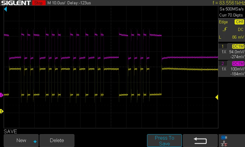

Oscilloscope reading on the CANH CANL lines
_legacyfs_online_stmicro_images_0693W00000bjJx0QAE.pngI have gone through posts (Link1, Link 2) who had similar issues, and I'm not facing that issue. My Std Filters Nbr=1 and Interrupt is enabled.
I'm not sure what I'm missing. Any help is appreciated.
Best answer by MMoha.10
Hi Slawek,
Thank you for getting back. I haven't tried your suggestion yet. But this worked out for me : https://github.com/mackelec/meFDCAN
