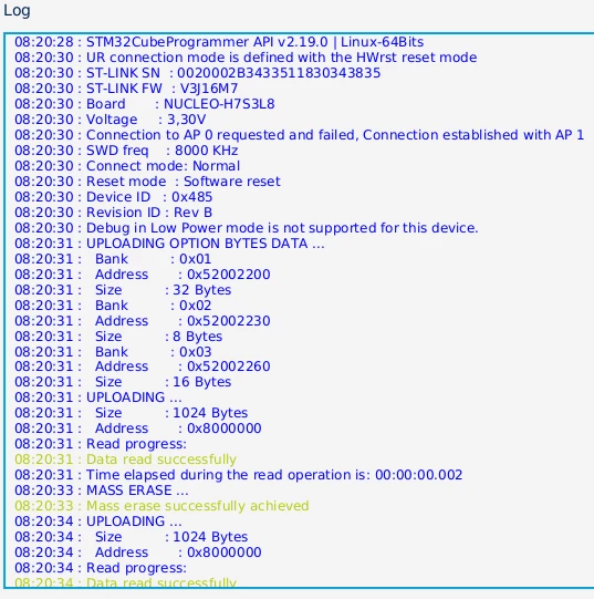

    However, after performing an Xth reset with the STM32CubeProgrammer, I remarked something in the logs :
    The AP0 seemed to be closed. I thus modified the AP into STM32CubeIDE Debugger Configuration :
    After that, I was able to Debug the board.

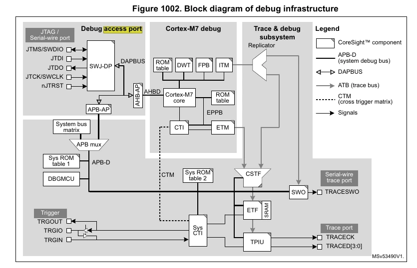

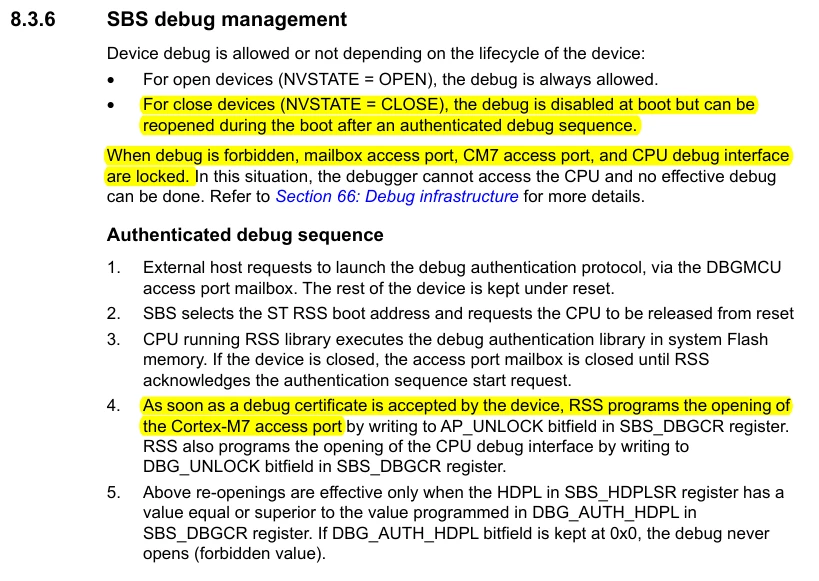

    @KDJEM.1, do you have an idea why the AP used by default (AP0) in STM32CubeIDE Debugger is closed ?According to the Reference Manual (RM0477), there are two Debug APs : APB-AP (DBGMCU) and AHB-AP (Cortex M7) :
    AHB-AP (Cortex M7) might be closed when debug is disabled (NVSTATE = CLOSE). It then needs to be opened via APB-AP :
    Is the base project for NUCLEO-H7S3L8 configuring NVSTATE = CLOSE by default in the FLASH register ? Why is it the case ? If it is the case, why not adapting the default debugger configuration ?
