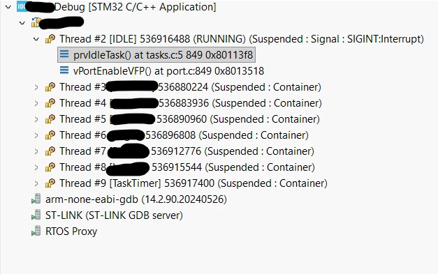

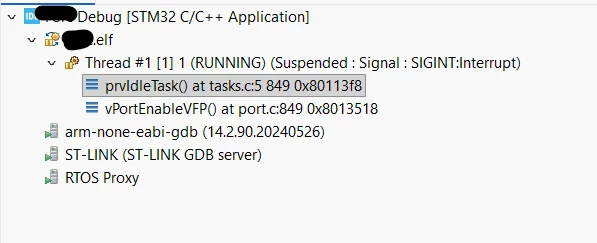

Hi
The symptoms were that the tasks were listed so that the call stack could be investigated
This is what i expect
This is what i got
Best regards
Martin

Hi @DreamOnDirac,
I heard rumor that the version of the RTOS proxy which is integrated into 2.10 has a regression bug compared to 2.0.0. I imagine that one solution would be to replace the RTOS proxy tool from 2.1.0 with the one from 2.0.0...
You find them "roughly" ("roughy" since I am on Mac, you are probably on Windows) here:
STM32CubeIDE 2.1.0/plugins/com.st.stm32cube.ide.mcu.externaltools.rtosproxy.macosaarch64_1.0.0.202601281726/tools
Make a back-up of the tools folder and then replace it with the one from 2.0.0....
Appologies for the inconvenience!
Kind regards, Mattias
Visitor II
Mar 10, 2026 3:51 PM UTC
I had the same problem on linux after upgrading.
After executing the following command in the plugins folder, the task list is visible again.
cp -r com.st.stm32cube.ide.mcu.externaltools.rtosproxy.linux64_1.2.100.202412131345 com.st.stm32cube.ide.mcu.externaltools.rtosproxy.linux64_1.2.200.202601091506
