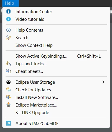

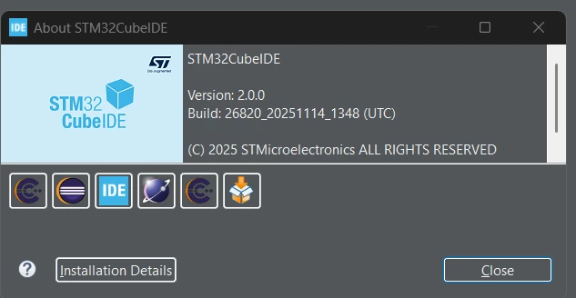

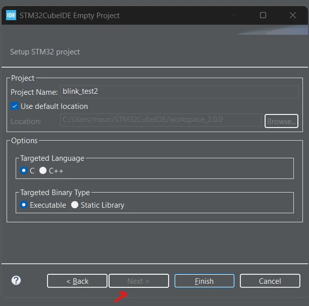

Dec 5, 2025 2:57 AM UTC
I got the same problem: cube ide is not generating ioc file
it did not enable "next" option,
I have latest version 2.0.0 (windows 11)
I tried, "Go to Window > Preferences > STM32Cube > Firmware Updater." but that option is not visible,
also I tried "Go to Help > STM32Cube updater > Select “Check the Target selector Device Database Updates”" but "STM32Cube updater" option is not visible,
what can I try now?
Dec 5, 2025 9:25 AM UTC
Hello @Maurilio-P97
Starting from version 2.0.0, STM32CubeIDE is separated from STM32CubeMX, this is posted in this thread and also discussed here.
For device configuration, you should download the standalone version of STM32CubeMX.
KR, Souhaib
