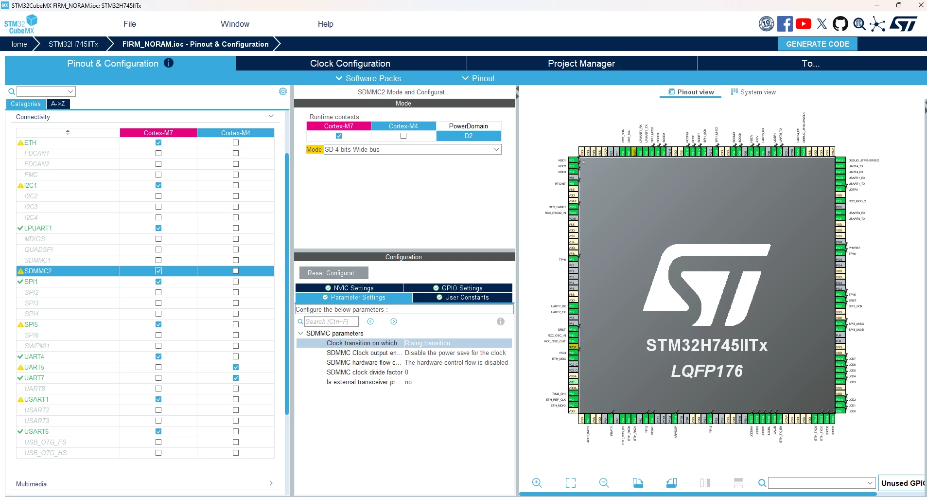

Initially I set mode: SD 4 bits Wide bus and configuration is:SD.png
NVIC: Enabled
NO constants
GPIO Setting:
- PB3: D2, PB4: D3, PB14: D0, PB15: D1, PD6: CK and PD7: CMD
- DMA: not exist??

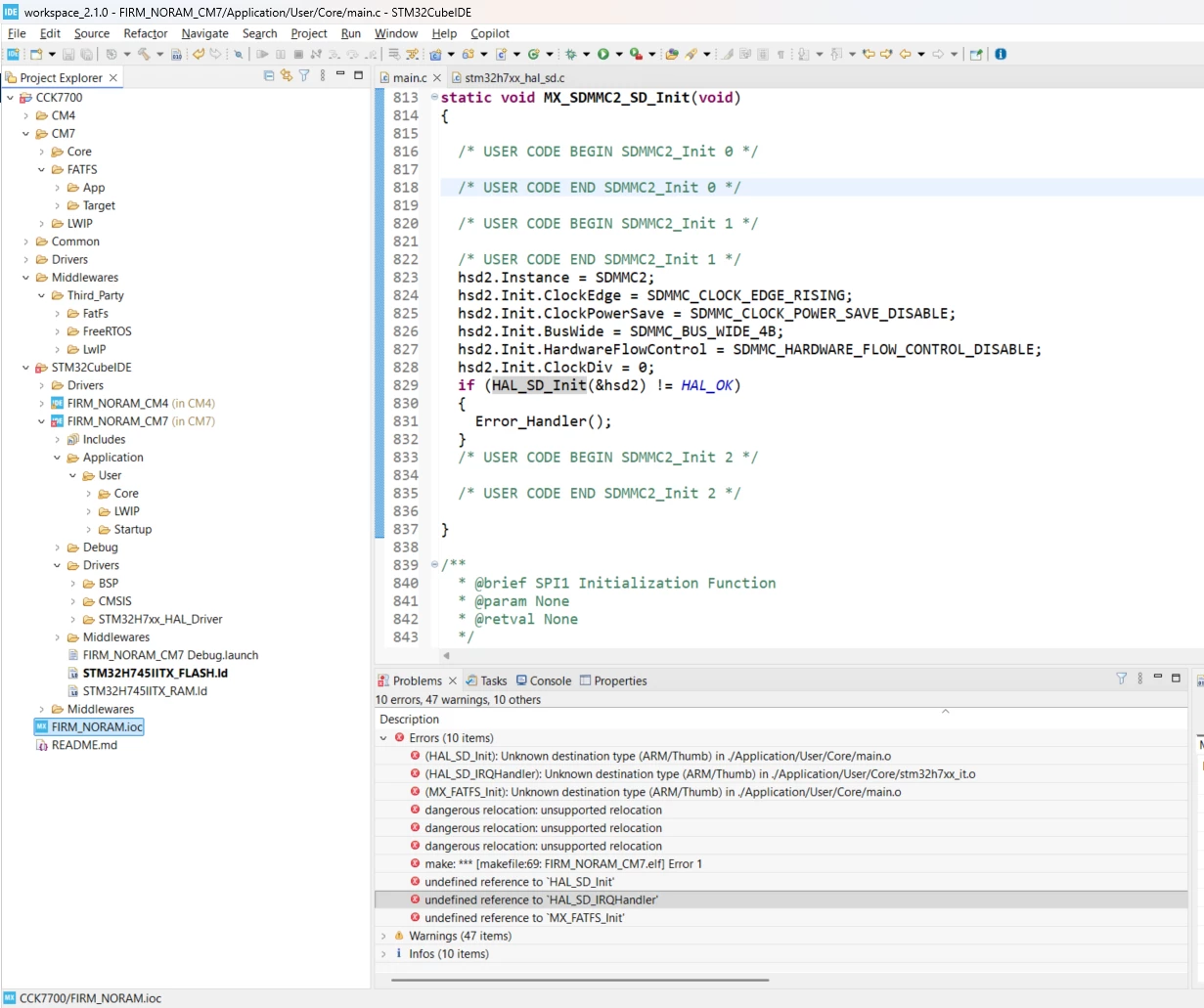

Only with this code is the following error generated in CubeIDE:
(HAL_SD_Init): Unknown destination type (ARM/Thumb) in ./Application/User/Core/main.o
(HAL_SD_IRQHandler): Unknown destination type (ARM/Thumb) in ./Application/User/Core/
undefined reference to `HAL_SD_Init'
undefined reference to `HAL_SD_IRQHandler'

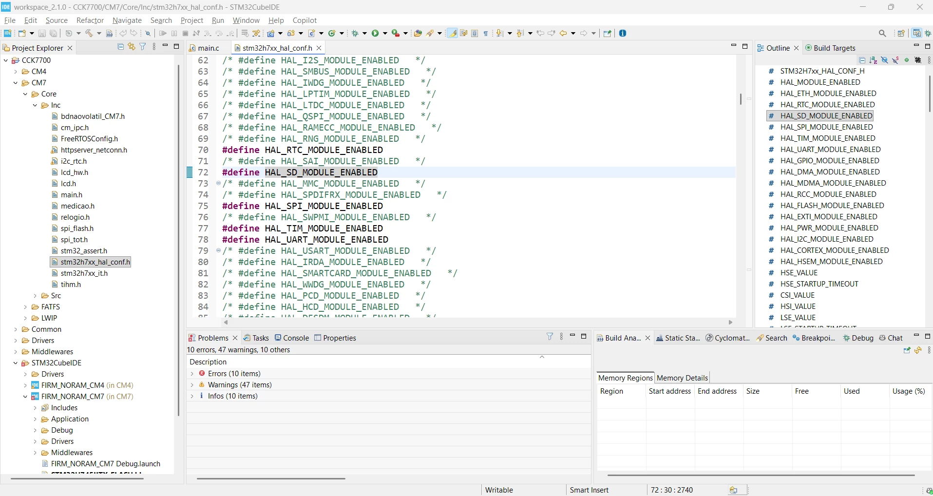

Hello @JEAN_121188
Is the macro #define HAL_SD_MODULE_ENABLED is defined in stm32h7xx_hal_conf.h. If this define is missing, the SD HAL APIs such as HAL_SD_Init() and HAL_SD_IRQHandler() may not be compiled correctly.
In order to give better visibility on the answered topics, please click on 'Best answer' on the reply which solved your issue or answered your question. Saket_Om
May 6, 2026 11:45 AM UTC
Hello @Saket_Om
Thank for your help! Yes the macro #define HAL_SD_MODULE_ENABLED was defined in stm32h7xx_hal_conf.h
What I find strange is the location of these files:
stm32h7xx_hal_conf.h is in:
..\workspace_2.1.0\CCK7700\CM7\Core\Inc\stm32h7xx_hal_conf.h
and the M7 main file is in:
..\workspace_2.1.0\CCK7700\CM7\Core\Src\main.c
see project explorer in left
By, have a beautiful day!
May 6, 2026 1:58 PM UTC
Could you please share your .ioc file?

May 6, 2026 2:51 PM UTC
Yes, have many erros:
Description Resource Path Location Type
(HAL_SD_Init): Unknown destination type (ARM/Thumb) in ./Application/User/Core/main.o FIRM_NORAM_CM7 C/C++ Problem
(HAL_SD_IRQHandler): Unknown destination type (ARM/Thumb) in ./Application/User/Core/stm32h7xx_it.o FIRM_NORAM_CM7 C/C++ Problem
(MX_FATFS_Init): Unknown destination type (ARM/Thumb) in ./Application/User/Core/main.o FIRM_NORAM_CM7 C/C++ Problem
dangerous relocation: unsupported relocation FIRM_NORAM_CM7 line 0, external location: C:\Users\jeand\STM32CubeIDE\workspace_2.1.0\CCK7700\CM7\Core\Src\main.c:263 C/C++ Problem
dangerous relocation: unsupported relocation FIRM_NORAM_CM7 line 0, external location: C:\Users\jeand\STM32CubeIDE\workspace_2.1.0\CCK7700\CM7\Core\Src\main.c:829 C/C++ Problem
dangerous relocation: unsupported relocation FIRM_NORAM_CM7 line 0, external location: C:\Users\jeand\STM32CubeIDE\workspace_2.1.0\CCK7700\CM7\Core\Src\stm32h7xx_it.c:215 C/C++ Problem
make: *** [makefile:69: FIRM_NORAM_CM7.elf] Error 1 FIRM_NORAM_CM7 C/C++ Problem
undefined reference to `HAL_SD_Init' FIRM_NORAM_CM7 line 0, external location: C:\Users\jeand\STM32CubeIDE\workspace_2.1.0\CCK7700\CM7\Core\Src\main.c:829 C/C++ Problem
undefined reference to `HAL_SD_IRQHandler' FIRM_NORAM_CM7 line 0, external location: C:\Users\jeand\STM32CubeIDE\workspace_2.1.0\CCK7700\CM7\Core\Src\stm32h7xx_it.c:215 C/C++ Problem
undefined reference to `MX_FATFS_Init' FIRM_NORAM_CM7 line 0, external location: C:\Users\jeand\STM32CubeIDE\workspace_2.1.0\CCK7700\CM7\Core\Src\main.c:263 C/C++ Problem

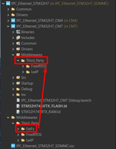

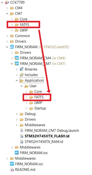

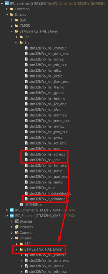

May 7, 2026 12:50 PM UTC
Hello!!!
The problem today resolved!!! two methods are used: firts the solution by @Andrew Neil with solution of the occurrence of the "dangerous relocation: unsupported relocation.
Secound with Brasil support ST: Was movie archive of the comum path from projetc:
I would like to thank everyone who helped me @Mahmoud Ben Romdhane @Saket_Om and @Andrew Neil
