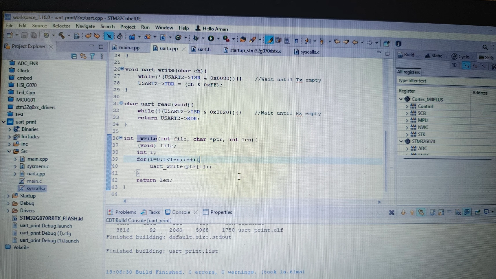

I'm trying retarget printf. My uart_write function is working correctly and i'm able to see character on Teraterm.

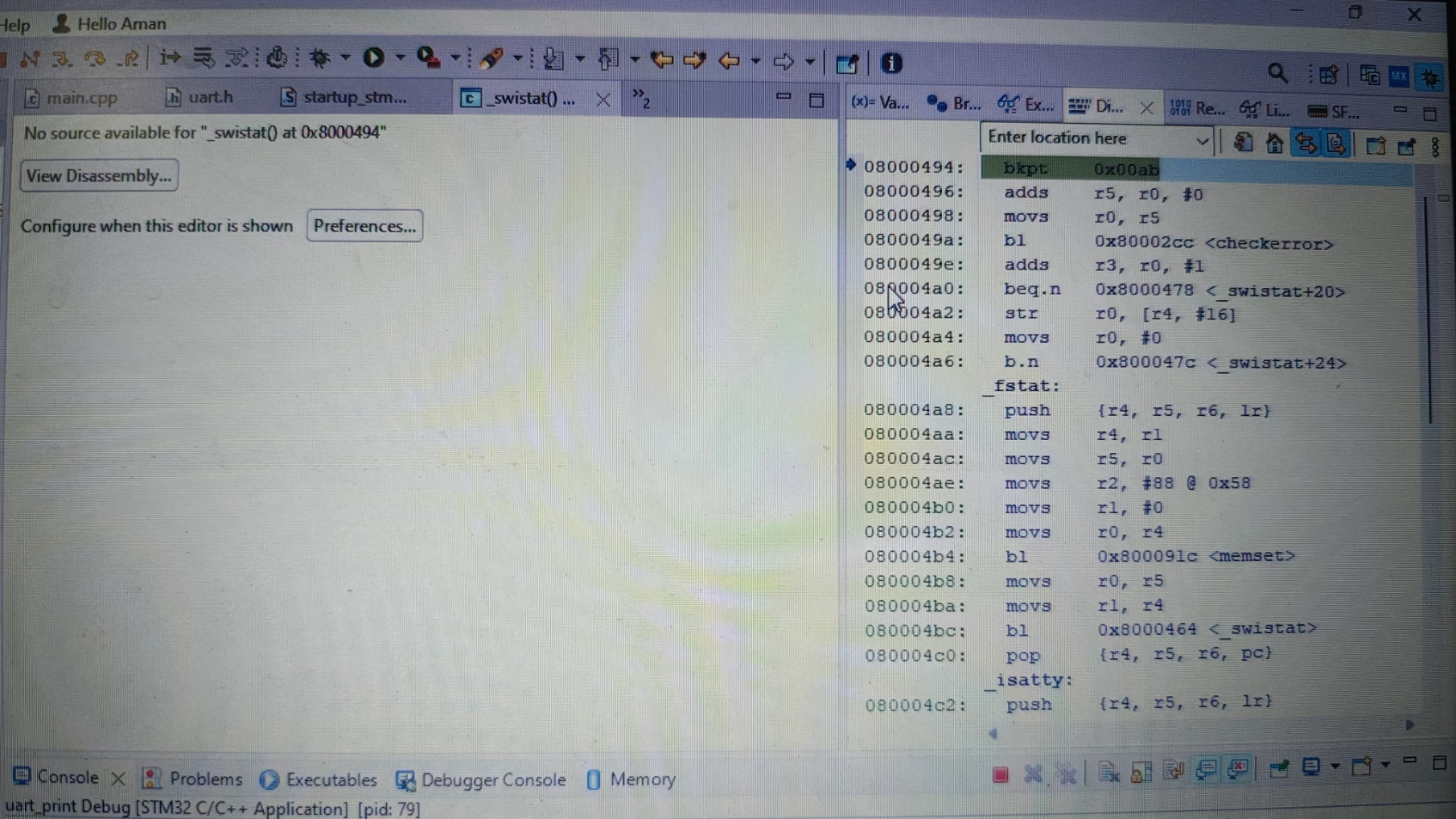

But when i try to use printf it is not working. i even tried semihosting to execute printf but it fails. i'm attaching the screenshots -
any solution for this problem?

    It really shouldn't make any difference - they all just end up writing to the UART.
    If you're hitting a BKPT instruction, that suggests you're configured for semihosting - you don't want that.
    Presumably, the screenshots you shared show your semihosting attempt - as this works via the BKPT instruction?
    https://interrupt.memfault.com/blog/arm-semihosting
    Instead, follow the Knowledge Base article linked by @KDJEM.1
    And here's a 3rd-party article on the same: https://shawnhymel.com/1873/

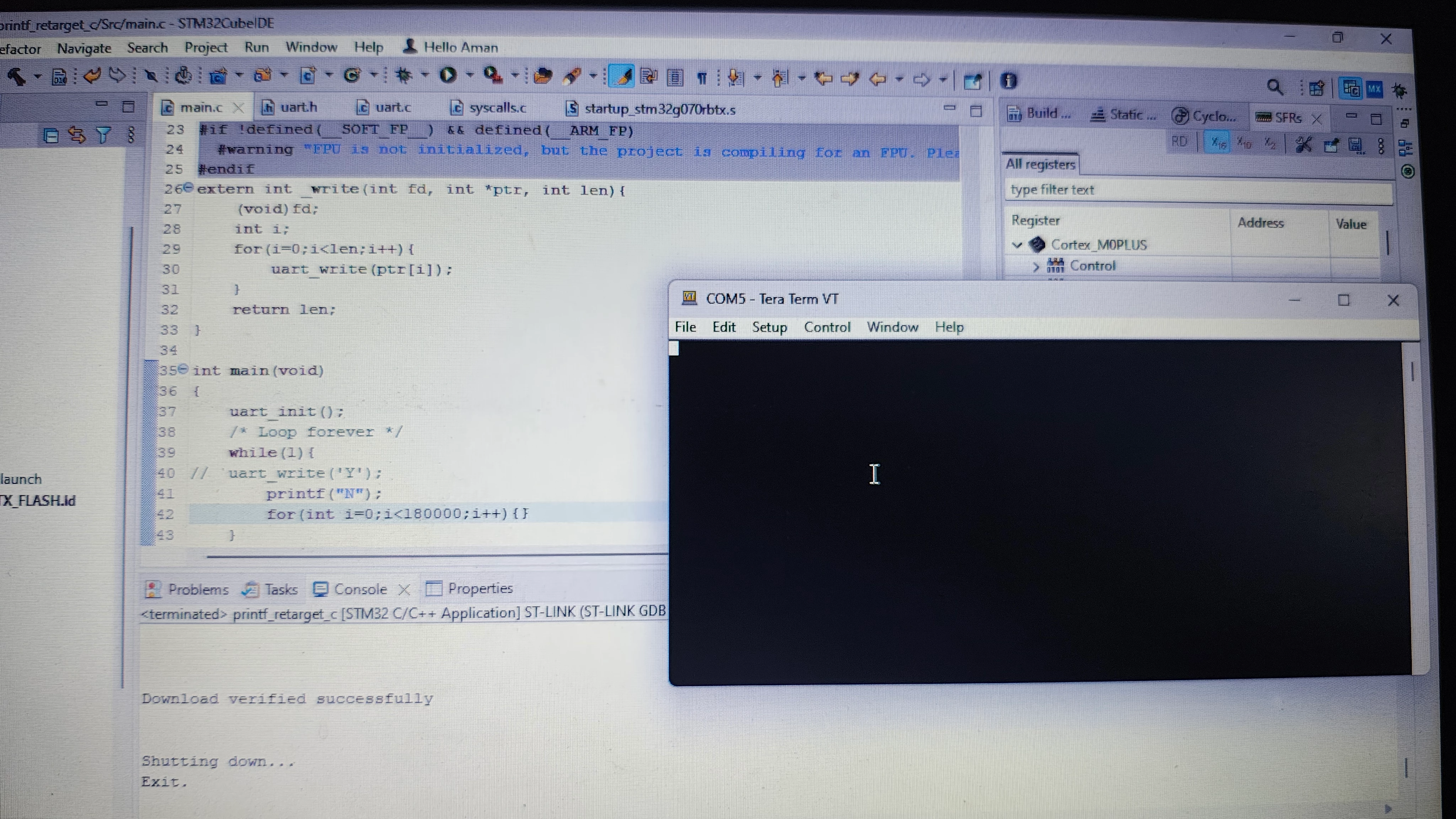

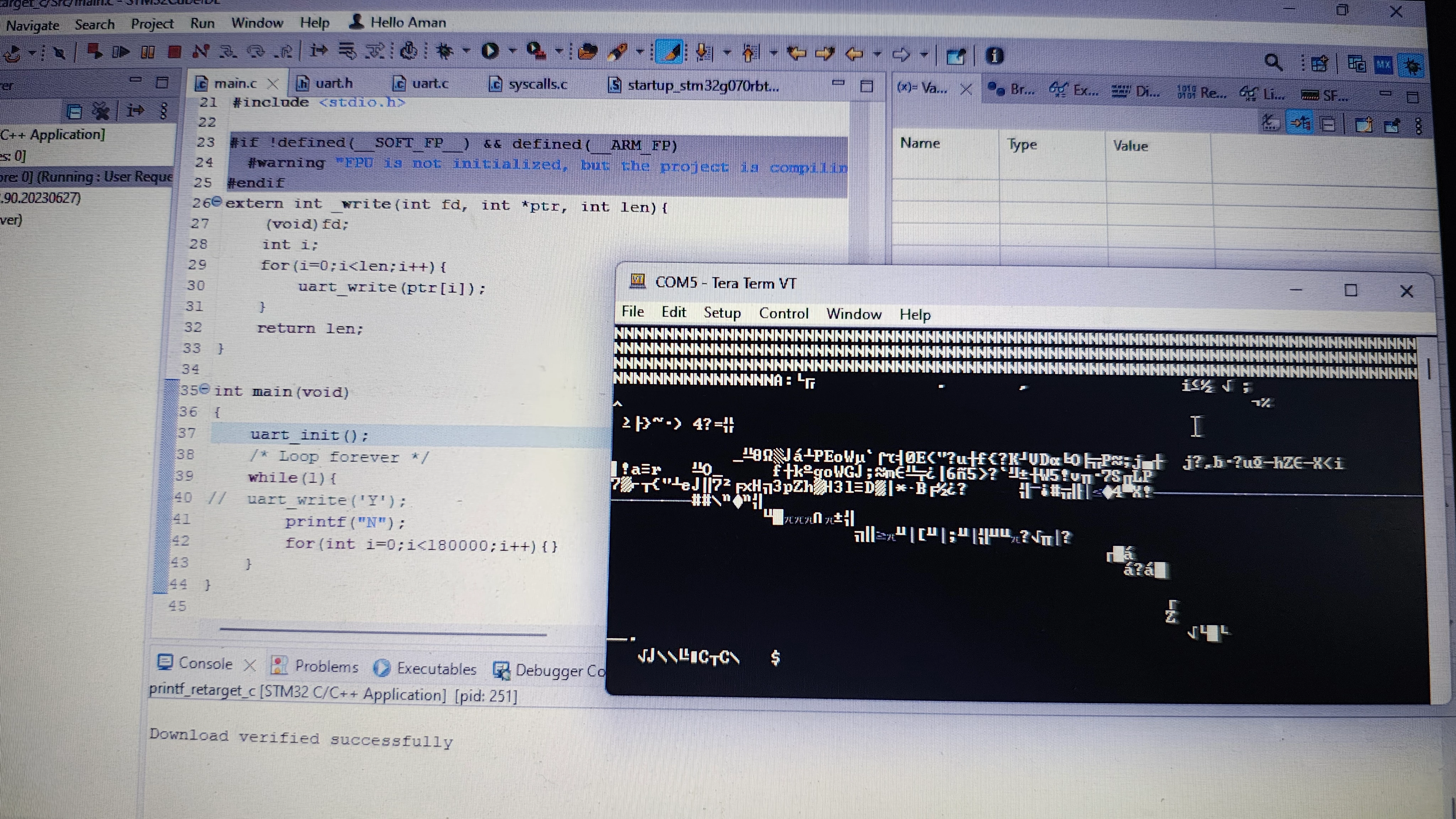

    Tried with the C project as well it's not working.
    It printed few lines then threw some garbage. I retried debugging but now nothing displayed on terminal.
    Do I need to increase baud rate from 9600 to 115200? Because it's taking time to print.
    What do you mean by that?
    Remember that printf is line-buffered - it won't (usually) send its output until it gets a newline...
    stderr isn't buffered:
    https://community.st.com/t5/stm32cubeide-mcus/can-t-get-printf-to-work-on-cubeide/m-p/701740/highlight/true#M29337
