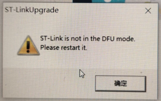

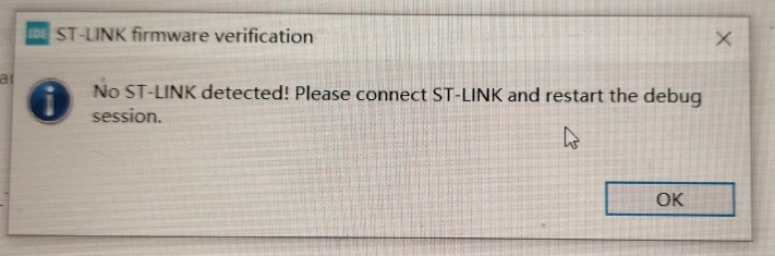

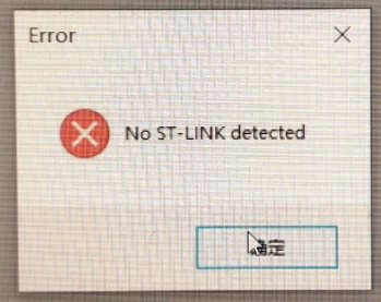

hello my friends!I'm trying to find a solution to this problem. I'm doing an experiment with a small light, and I encountered a problem that pops up a dialog box like this after compiling and downloading, and it has something to do with ST-link, so I hope some of my friends can solve the problem.

You're trying to do a firmware update, but the ST-Link is not in the correct mode ("DFU mode") for doing a firmware update.

CubeIDE cannot see any ST-Link connected to your computer.
If you've had a failed firmware update, that could explain it.
First question - do you have a genuine ST-Link?
https://community.st.com/t5/stm32-mcus/how-to-recognize-a-genuine-st-link-v2-versus-a-cloned-one/ta-p/49471
In particular:
https://community.st.com/t5/stm32-mcus/how-to-recognize-a-genuine-st-link-v2-versus-a-cloned-one/tac-p/703663/highlight/true#M965
Also, is your STM32 genuine? (if it's on a blue, black, or other coloured "Pill", it probably isn't)
On resolving connection issues:
https://community.st.com/t5/stm32-mcus/how-to-solve-debugger-connection-issues/tac-p/698105/highlight/true#M956
https://community.st.com/t5/stm32-mcus/how-to-solve-debugger-connection-issues/ta-p/49693
