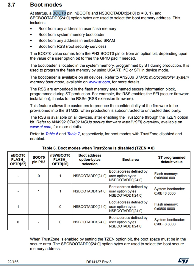

In my module (STM32WBA5MMGH6TRTR), there is only one pin for boot selection BOOT0. I believe when it is pulled low booting happens from main flash memory. But when it is high , from where the module is booting.

The STM32WBA5MMG module contains a STM32WBA55UG wireless microcontroller.
You need to look at the microcontroller datasheet for the behaviour of the BOOT0 pin:
https://www.st.com/resource/en/datasheet/stm32wba55ug.pdf#page=22
