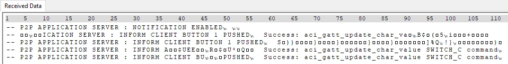

ledi7Author
Jan 22, 2025 8:54 AM UTC
Hello @STTwo-32 ,

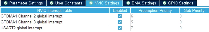

Thanks for the information! It works, but only if BLE is not activated (no advertising, no BLE connection). I use the same settings for USART2 as for USART1 with 19200 Baud. The NVIC priorities are also the same.
When I send a byte from HTerm to USART2, I use the Rx callback function in usart_if.c to trigger the task for a notification event (just like when pressing Button1 on the NUCLEO board).
static void UsartIf_RxCpltCallback(UART_HandleTypeDef *huart)
 /* USER CODE BEGIN UsartIf_RxCpltCallback 1 */
 UTIL_SEQ_SetTask( 1<<CFG_TASK_SEND_NOTIF_ID, CFG_SEQ_PRIO_0);
 /* USER CODE END UsartIf_RxCpltCallback 1 */
 RxCpltCallback(&charRx, 1, 0);
 HAL_UART_Receive_IT(&huart2, &charRx, 1);
 /* USER CODE BEGIN UsartIf_RxCpltCallback 2 */
 /* USER CODE END UsartIf_RxCpltCallback 2 */

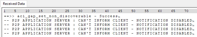

If no advertising or no ble connection is active, I get the log information (here i send a byte four times via HTerm) without errors:
But when advertising or a BLE connection is active, I usually get confused characters as log information. Here, i also send a byte four times when a BLE connection is established:
