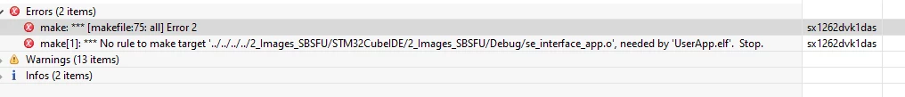

LoRaWAN FUOTA example SX1262DVK1DAS & NUCLEO-L476RG
While building the example FUOTA code from icubelrwan software expansion. I am facing "No rule to make target error" attached the screenshot.

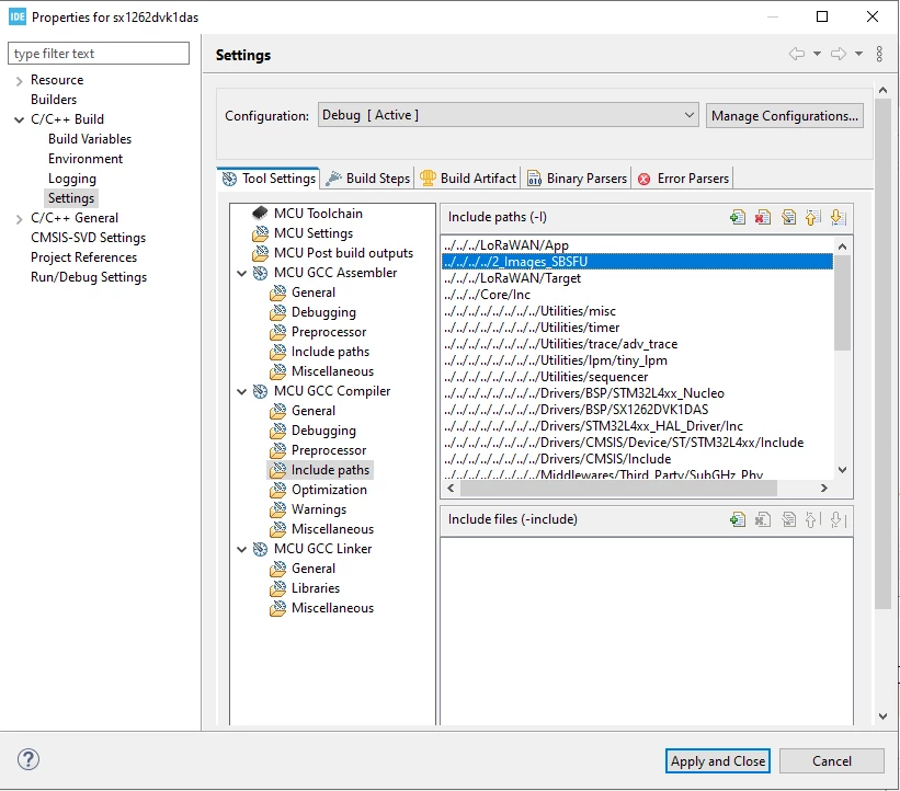

Tried to build after including the path of the folder but still facing the same error. attached the screenshot.
Support me in resolving this error.

Hello @Stm32_dev and welcome to the Community :),
I apologize for my late reply.
Thank you for bringing this issue to our attention. I confirm the issue when using STM32CubeIDE 1.15.0 and I reported internally.
It is mentioned in the release note projects of I-CUBE-LRWAN that the development toolchain and compiler used for this package is STM32CubeIDE v1.6.1. For that please try to update the STM32CubeIDE toolchain.
May these posts can help you: Post1 and Post2.
Internal ticket number: 181244 (This is an internal tracking number and is not accessible or usable by customers).
