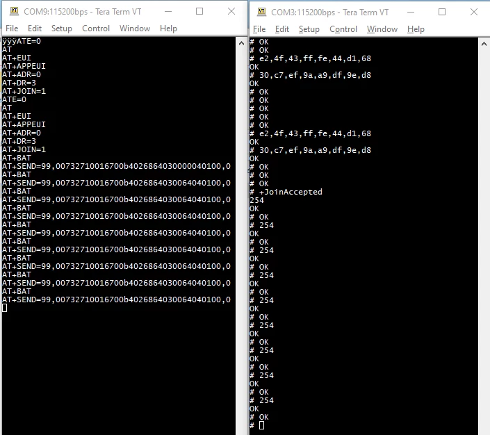

oK , we see the TX (ATE is a md to disable echo). Normally after we must have the AT cmd to see is the modem is ready and then the AT+JOIN=1. Should seem that problem come just afetr ( yes could be unexpected interrupt ???). Could to could plug the spy on the RX ( modem to master transmission) to see the return value coming from Modem. Is it possible for you to to step by step up to the Lora_fsm() (line 99 - app_master.c file)

here is the trace ( Rx pin) transmitted by the modem at reset .. Then after join accepted modem return 254 for battery level and return code OK for the sending frame . On Tx we see the AT+SEND cmd

JCOUP
Visitor II
Jul 22, 2021 9:24 AM UTC
Here are two files, one giving the reboot sequence we have to do and the second one giving the sending trace

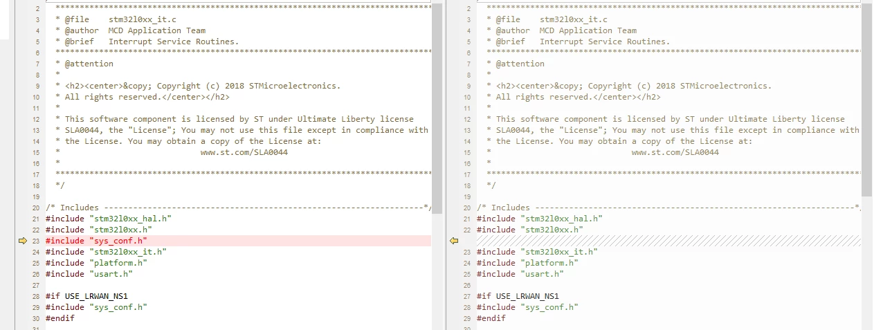

Visitor II
Jul 26, 2021 3:25 PM UTC
OK and sorry for this omission. I did a complete compare between your Project and my project . In the file stm32l0xx_it.c we have to include the header file "sys_conf.h" (see attached file)

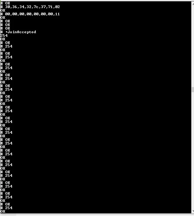

Andrew Neil
Jul 26, 2021 3:43 PM UTC
Ah - that's better:
0693W00000D0eakQAB.pngnow to see what's happening at the TTN end ...
JCOUP
JCOUPBest answer
Visitor II
Jul 26, 2021 3:47 PM UTC
OK, we see that the join has been accepted... 254 is the response to the battery level request and data has been send to the 99 port.. keep me info on the TTN result
