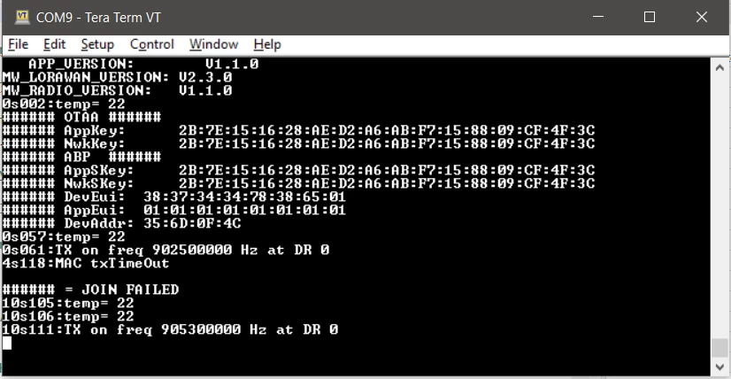

I then flashed the AT_master provided in STM32CubeExpansion_LRWAN_V2.1.0\Projects\NUCLEO-L073RZ\Applications\LoRaWAN\LoRaWAN_AT_Master and got the following in Capture1. Note: I changed Debugger_ON to 1 in sys_conf.h. Anything that I typed did not respond to me.
I then tried to flash the END_node located in STM32CubeExpansion_LRWAN_V2.1.0\Projects\NUCLEO-L073RZ\Applications\LoRaWAN\LoRaWAN_End_Node, while making sure I changed the region located in lora_app.h and lorawan_conf.h I also turned debugger ON. Static_device_EUI is set to 0 so I added a device on the TTN that way. The results I got is in Capture20693W00000FBCgpQAH.png
I can't get anything to work and don't know where to start to try and fix this. If there is any other information that I missed please let me know.

Hi, I'm Erton and purchase a P-nucleo-LRWAN2 and i can't run any exemples on STM32CubeExpansion_LRWAN_V2.1.0, my board and shield is a L073RZ and I-NUCLEO-LRWAN1.
In my case, i disable debug and now is my teraterm is
0693W00000NpzErQAJ.pngI noticed the index #USE_I_NUCLEO_LRWAN1 is gray in all code. I try rebuild the index but
unsuccessfully. Can someone help me?
