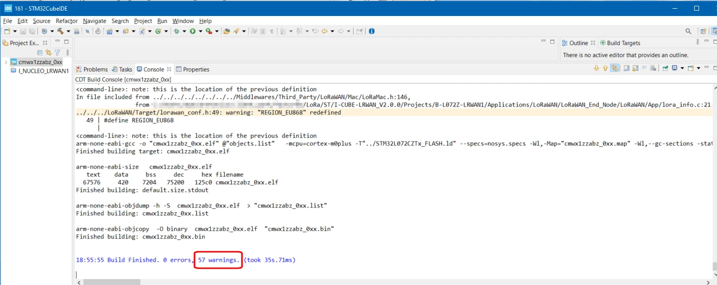

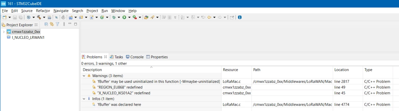

Well, not a good start: building straight "out-of-the-box" - 57 Warnings:
Which would seem to summarise as 3 real issues, repeated:

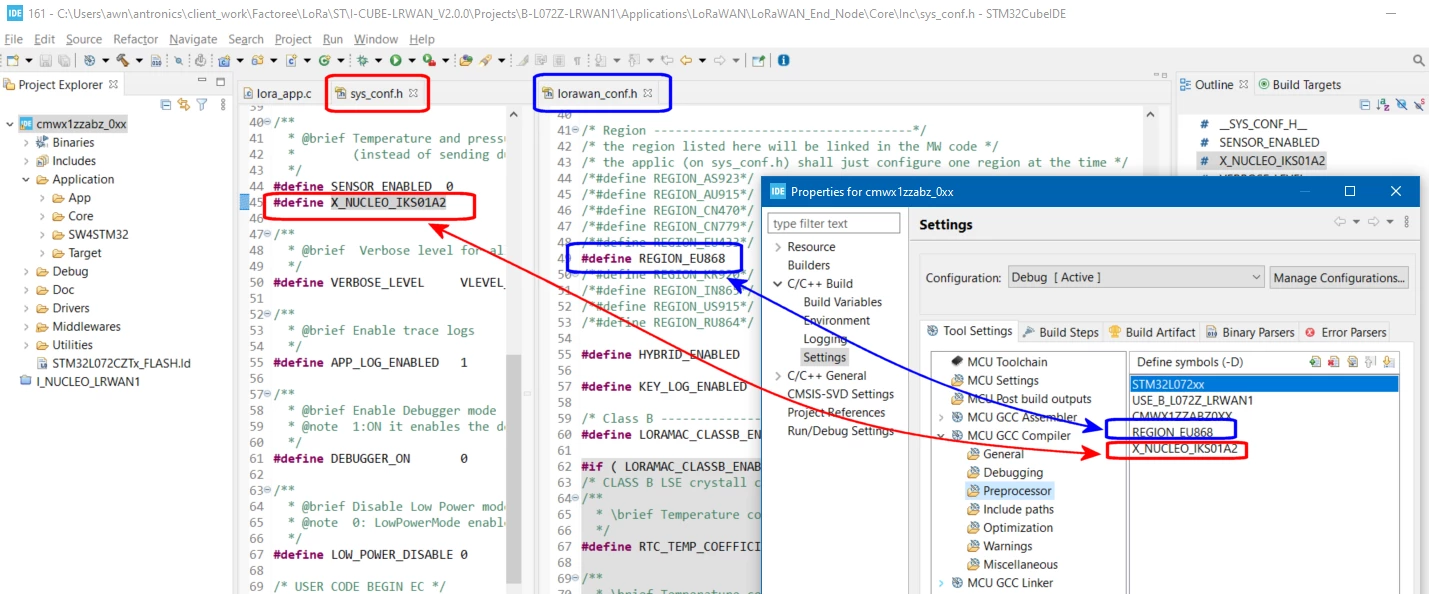

ADDENDUM
Sure enough, the REGION_EU868 and X_NUCLEO_IKS01A2 options are defined both in the Project setting and in source files:

The warning that 'fBuffer' may be used uninitialized seems to be from GCC inlining 'static' functions - as the warning is reported in PrepareFrame(), but the definition of fBuffer is in LoRaMacMcpsRequest()
