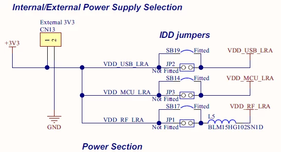

I have removed all the solder bridges & links to minimise stray consumption.
When I measure the combined current through JP3 and JP1 (ie, MCU & RF), it is ~0.87mA between Tx pulses.
(SB19,14,17 are removed; JP2 is not fitted - so no current to USB_LRA)

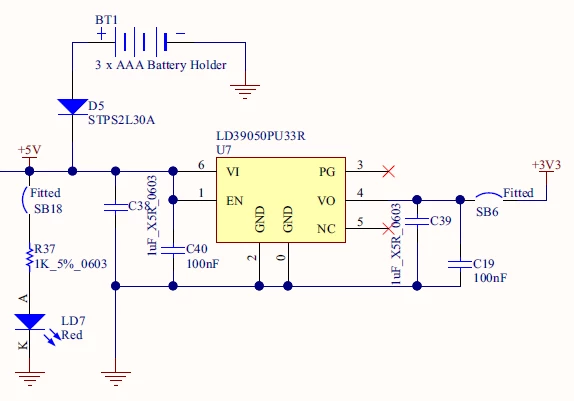

But, when I power the board from the battery, and measure the battery current, I see
1.95mA
(SB18 is removed)
The ST LD39050 regulator (U7) is supposed to be ''low quiescent current'': the datasheet says it should only, typically, be taking 100uA at 500mA load - so we should be nowhere near that!
So where is this extra milliamp going??

Best answer by Jacques Grandjean
Posted on March 07, 2018 at 06:44
Hey Andrew, try to remove D2! It's a link between battery and ST_link power with resistors 2k7 and 4k7...

There is a connection from the Target +3V3 to the ST-Link AIN_1 - via R26:
This is not mentioned in the list of ST-Link connections that needs to be isolated when making target  current measurements.
Removing this reduces the battery drain to 1.48mA - which is better, but still not there yet...

Looks like 2 possibilities:
  1. There is something else connected on +3V3 which is drawing this 600uA but is not shown on the schematic,
  2. There is a fault - perhaps (a) leaky capacitor(s).

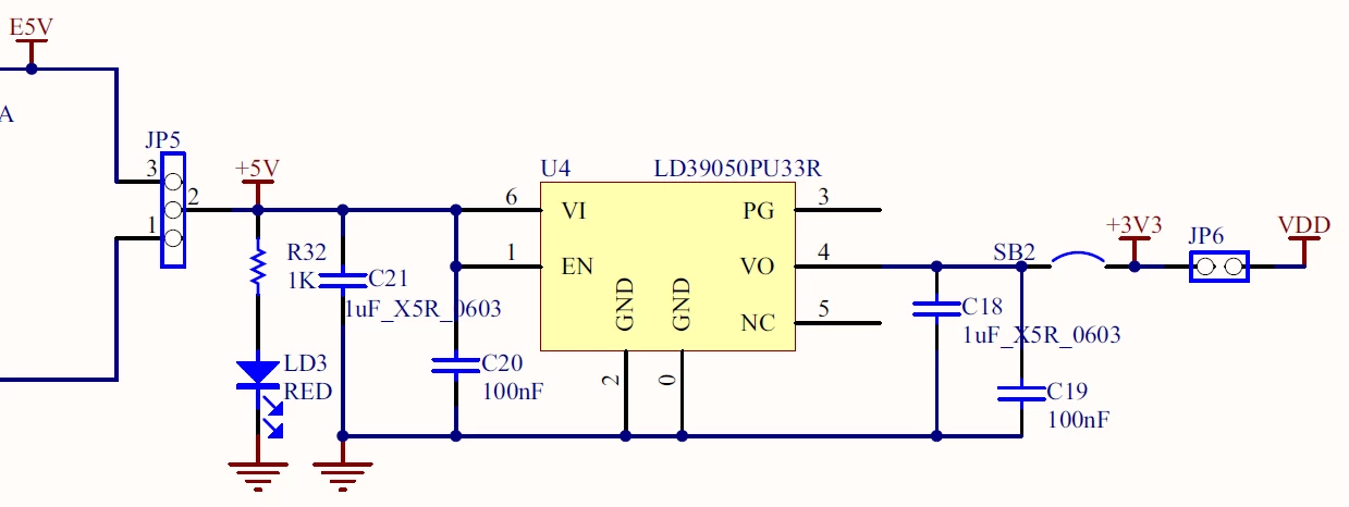

I just tried with an L152 Nucleo board - which has exactly the same regulator:
I removed R32 and JP6 (also R23 - which, again, feeds the +3V3 to the ST-Link).
With JP6 removed, there should be no load at all on +3V3 - and, indeed, the current into JP5.2 from exactly  the same source is 18uA.
So why is the same regulator, in the same configuration, giving well over an order of magnitude higher quiescent current on the B-L072Z-LRWAN1 ??
