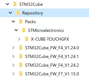

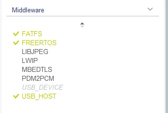

Hi Community,
I installed new STM32CubeIDE and TouchGFX.
I tried to refer to the youtube as https://www.youtube.com/watch?v=VOs2LYO7wSA.
I cannot find "graphics" in middle ware even if I selected STM32F746Discovery.
I attach the screen shot for my CubeIDE.
Of course, I installed TouchGFX from CubeIDE. Also, I attach my repository folder.
Could you please let me know how to solve this issue?
Thanks.
Best regards,
Kotetsu

Martin is talking about the sticky (a sticky is a post that stays at the top of the discussions page) in the TouchGFX section of the community:
https://community.st.com/s/topic/0TO0X0000003iw6WAA/touchgfx
And specifically this discussion about the TouchGFX 4.13.0 release:
https://community.st.com/s/question/0D50X0000BwjU6pSQE/official-release-xcubetouchgfx-v4130
Search for "Additional Software" in that discussion.
