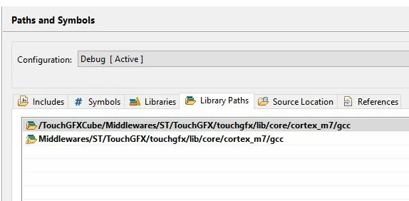

8)     Under ‘Library Paths’ add Middleware/ST/TouchGFX/touchgfx/lib/core/cortex_m7/gcc (provided your processor is an m7).

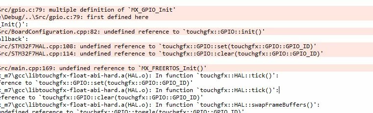

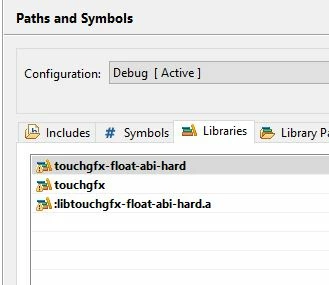

I followed all of your instructions and I got a error with the Libraries...
The compiler is not finding the 'libtouchgfx' and ‘touchgfx-float-abi-hard’ (I did the step 7 carefully and many times in different ways...).
Any idea for this error?
I've tried a lot of guides to generate code from STM32CUBEMX to Atollic with TouchGFX and this tutorial is the most complete and now for me I think is the last error to fix!
Thanks.

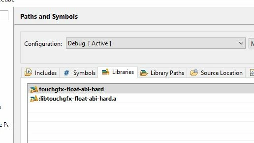

I hope these snips help - here's my working settings (make sure the library file is REALLY there too - mine wasn't until copied over)
I see an extra reference to the same library was generated when I used SMT32CubeMX again as a test!! So there are TWO different styles for finding the libraries...

BBenn
Feb 21, 2019 1:17 PM UTC
It appears only one is missing - libtouchgfx.a (which might not be needed?).
Is it actually in the folder??
I tested the build WITHOUT libtouchgfx.a - and it works fine, just REMOVE that library from "Libraries".
(You can also remove the first entry - the second is how STM32CubeMX generates the settings)

@BBenn​ , if I remove this library the compiler returns the same error. But I think is necessary because below you can see that the compiler call some functions in this library "touchgfx::HAL::tick()" for example.
Here is my situation:
Thanks.

Feb 21, 2019 2:08 PM UTC
All of those are library functions.
I am thinking perhaps your issue is the "Multiple definitions of MX_GPIO_Init" - there should only be ONE in main.cpp. I wonder if you have a second file included in the build with this function defined?
eng23
Senior
Feb 21, 2019 2:21 PM UTC
@BBenn​ , I have the MX_GPIO_Init function implemented in the gpio.c (generated by cube) and the call in the main.cpp, nothing else. Everything was generated by CubeMX.
About the second file I already searched for this function and appears only in gpio.c, gpio.h and main.cpp files.
Thansk for reply.

Feb 21, 2019 3:33 PM UTC
Oddly, my generated main.cpp has MX_GPIO_Init (the actual function) at line 1220, and I have no file GPIO.c (GPIO.cpp is just a base type).
Something is very different between what you have generated and mine.
