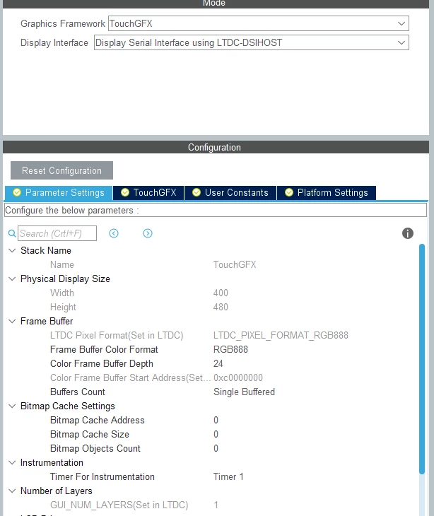

ADusi
Aug 20, 2019 12:38 PM UTC
Yes, width in cubeMx is set to 400 but I can't change this because it is inactive:
BBenn
Aug 20, 2019 12:44 PM UTC
Look at the LCD configuration - the DSI interface uses the LCD settings for display size... Looks like you fixed it anyhow in code.
