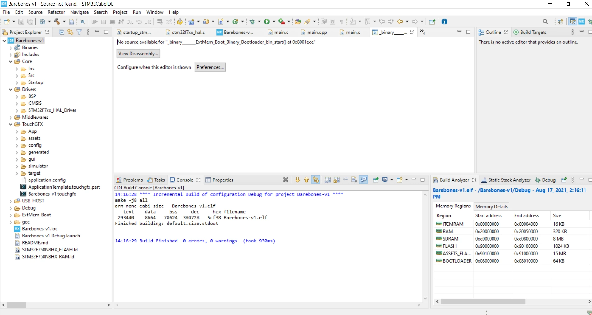

When I create the project on Touch-GFX and then import the project to the the STM32 Cube IDE , it build fine but when I run the program on the STM32F7508-D board it just becomes a white blank screen. When I click on the reset button it goes back to what it was last programmed to. It looks like it is not writing to the flash or something. Its an issue that is only board specific by the looks of it, since I have tried doing the same on the STM32F769I-DISCO and it works fine ?

I tried to create a new project from the STM32 IDE making sure all I set the IOC file is set up as what is done when the project is generated from TouchGFX. However, then I realised that some files were missing such as BSP drivers and also the gcc folder. After adding these files, the project build fine, however, it still doesn't seem to flash properly.
I also tried, what was mentioned above, my using STM32 Cube Programmer to program using the .hex files, but same issue exists.

Are you saying that the F750-DK Board Setup project does not work on CubeIDE ?
For the F750-DK, the MCU F750 is considered flashless which means that the code is directly saved in the external memory.
So if your external loader is correct and your code as well, the board should work (like I believe the Board Setup does).
But you will not be able to debug because the debugger cannot debug code from external memory.

When you open the project that is created by TouchGFX, the IDE will open up the project in the STM32 IDE folder. It builds completely fine and when I run on target it says complete, however, the screen is just a plain white screen.

CubeIDE does not work with F750-DK when it comes to debugging.
What I suggest is to build the project with CubeIDE and then download using CubeProgrammer. This methods works. This also means that debug is not possible.
I don't have the board with me so I cannot test myself but a colleague tested that debugging works with IAR. We will try to see how we can make CubeIDE work also for debugging.
