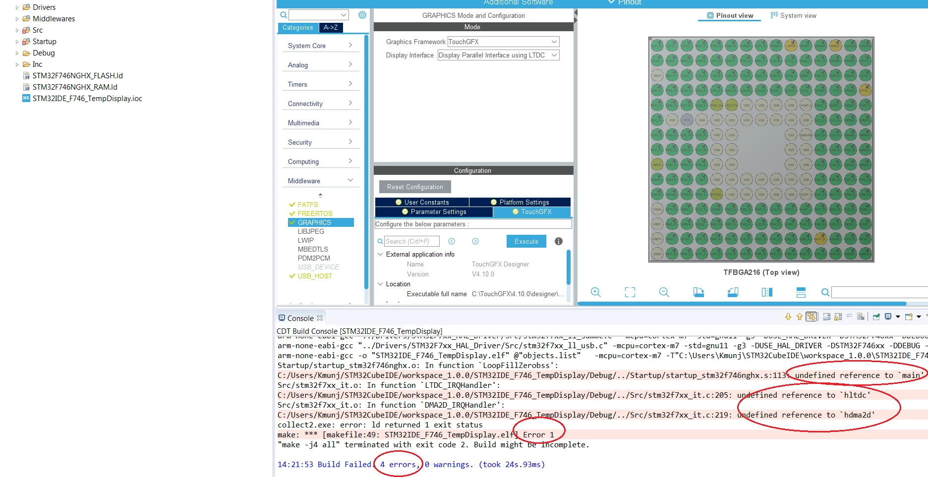

I am using 32F746Discovery Board as per your recommendation. Unfortunately I can't make much progress. I get errors immediately.

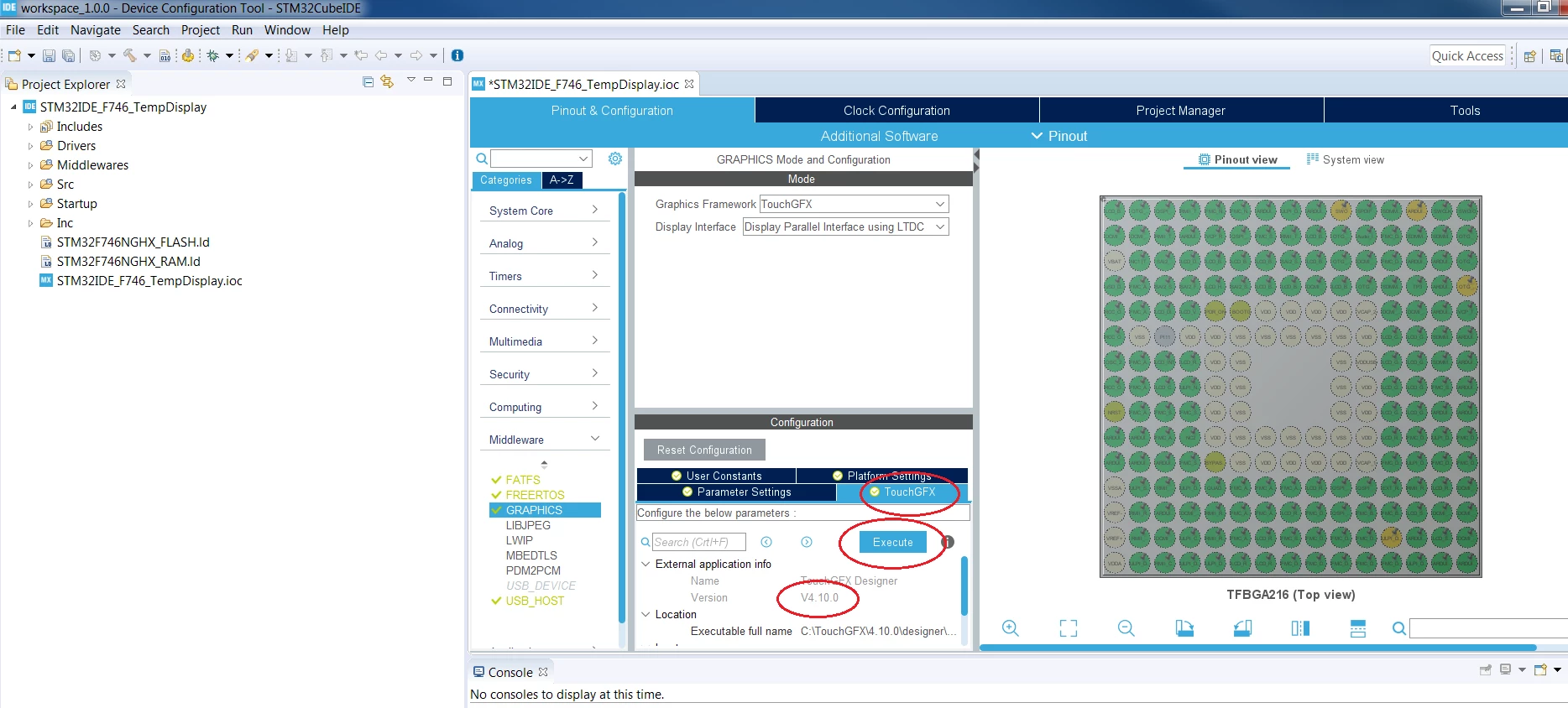

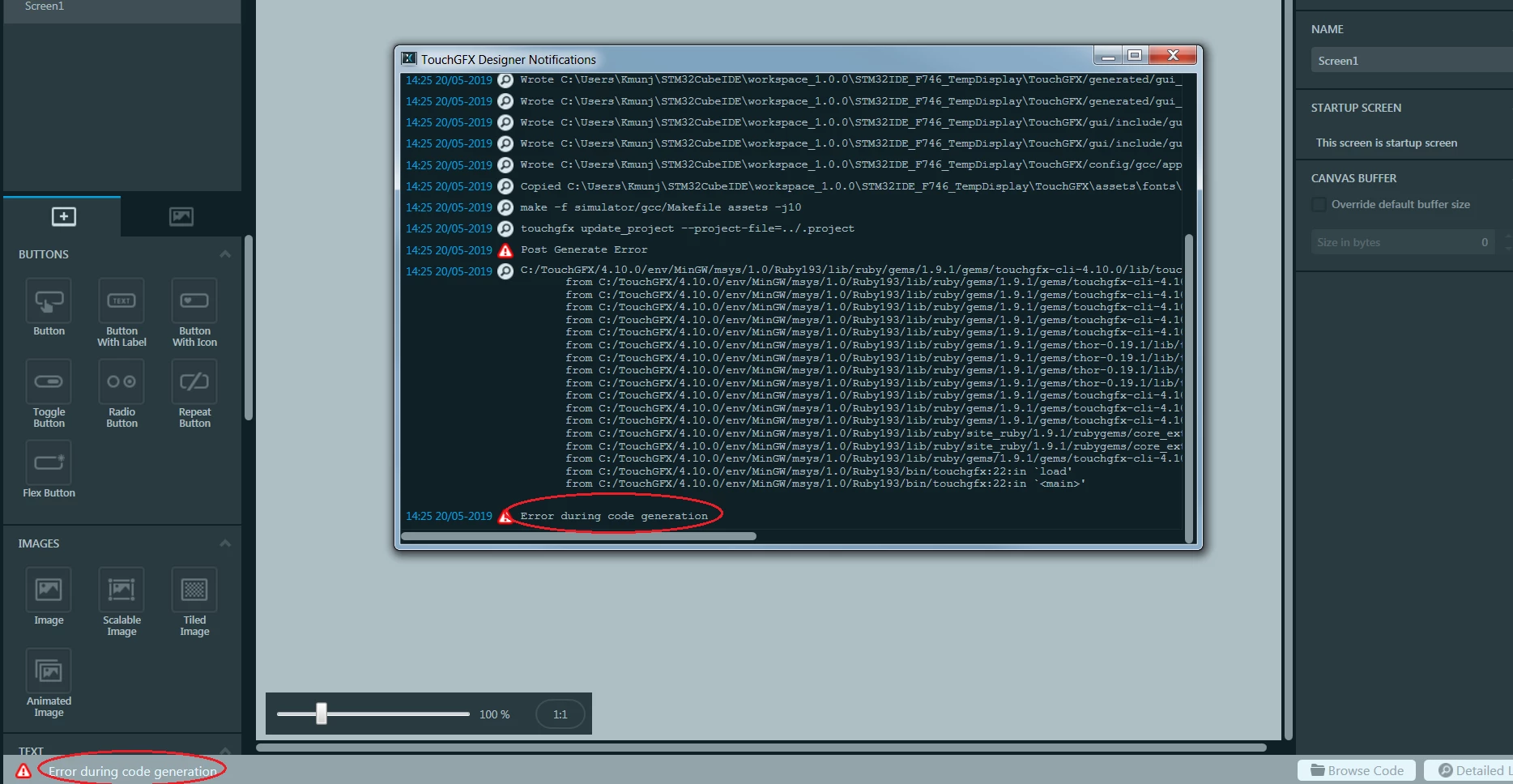

I open IDE and select 32F746Discovery. I keep all the defaults and name the project and open. Then I select graphics and select TouchGFX. I make sure every thing in that window is correct. (Attached -2). Then I do "Clean Build" and "Build". I get 4 errors. (Attached -3). So I do "Clean Build" and do "Execute" TouchGFX. It gets started and gives error "Error during code generation" (Attached -4). Then I tried to build the code, but IDE gets hung up.
Next time around, I did "Execute" 1st before and clean/build. But TouchGFX give same error "Error during code generation". I also selected C++ instead of C as Targeted language, but no matter I can't get rid of "Error during code generation" on TouchGFX.

KMunj
KMunjAuthor
May 20, 2019
​Here is -3.
Thanks
Kiran

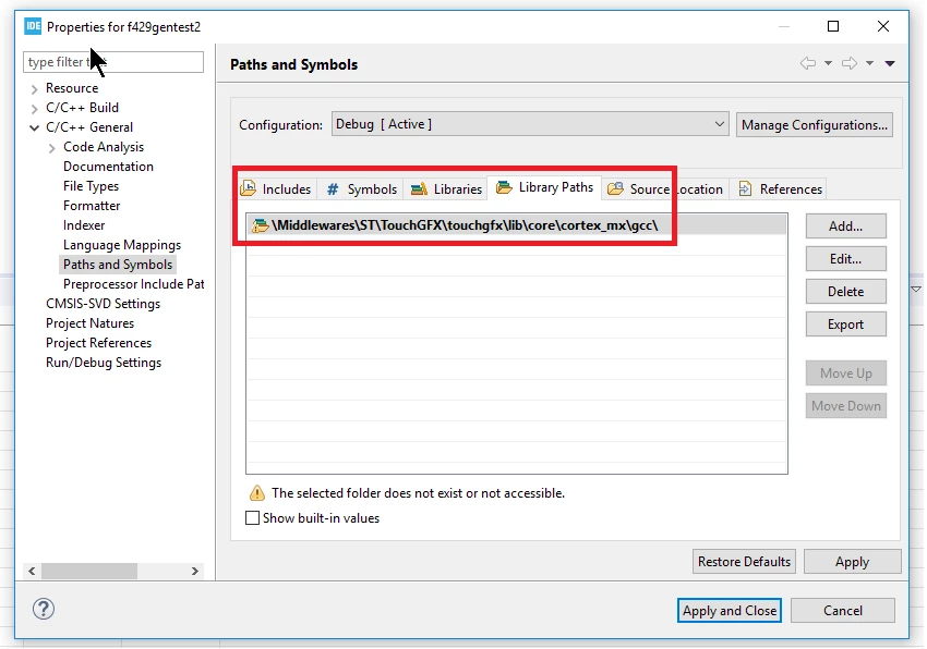

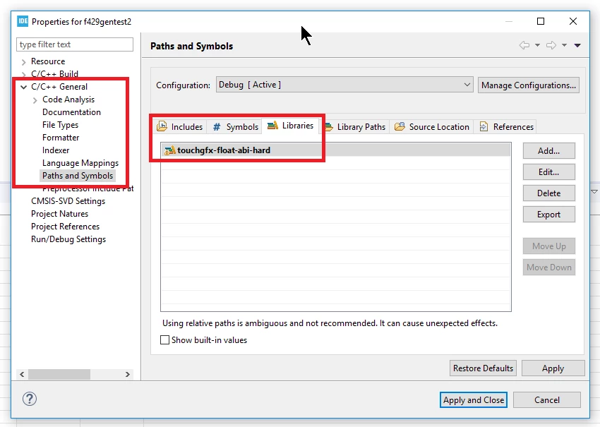

I don't know how to do #7. Is there any sticky for following how to do this?
  1. The library settings are wrong. Include the touchgfx library in MCU G++ Linker\Libraries:
    1. Libraries (-I): touchgfx-float-abi-hard
    2. Libraries search path (-L): \Middlewares\ST\TouchGFX\touchgfx\lib\core\cortex_mx\gcc\
Thanks.
-Kiran
Martin KJELDSEN
Principal III
May 23, 2019
Hi @KMunj​,
I'll update the description to be more concise - Here's a few screenshots of how to do this:

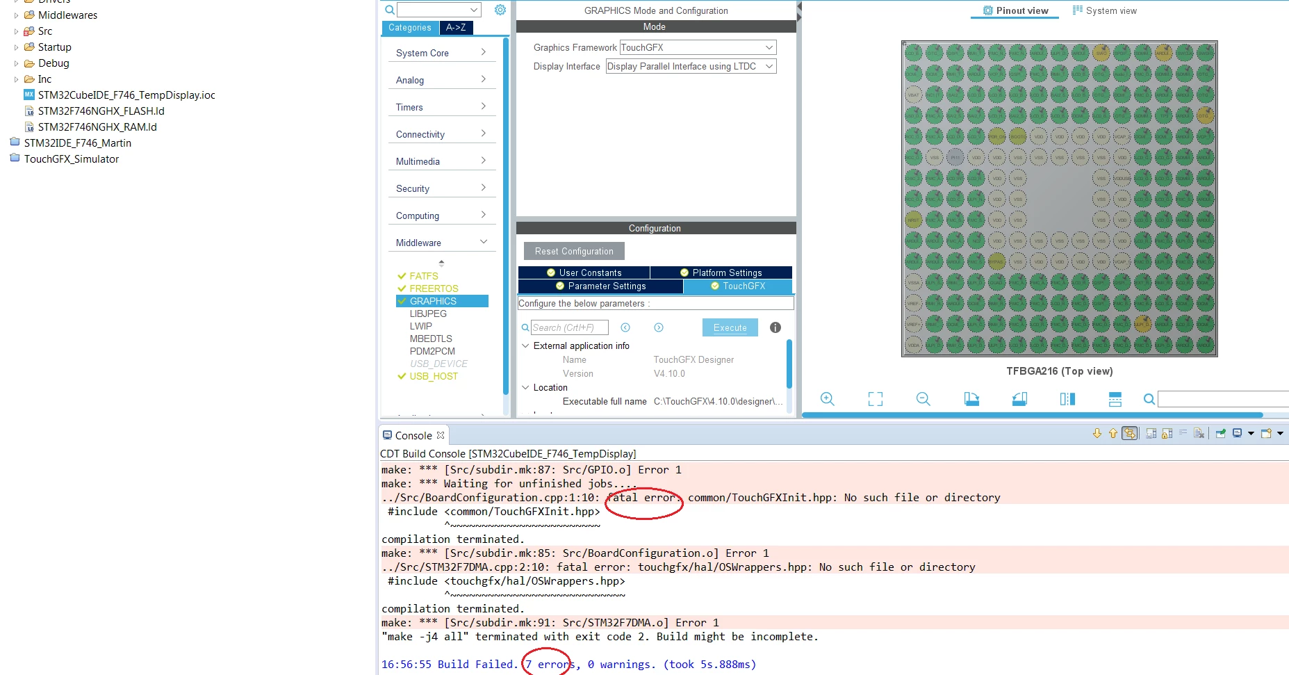

I followed all your steps, but something is still missing.
In your step 3, I added LCD Reset Pin XRES = PI12. This was required to make TouchGFX OK to Execute.
Without clicking Execute I built the project, but I got 7 errors. Please see attached.
Then I went thru rest of the steps. When I went to step 8 and built the code again, IDE got hung up.
I waited for 15 minutes, but no luck.
Thanks
Kiran
Martin KJELDSEN
Principal III
May 24, 2019
These errors seem to indicate that you did not Execute the TouchGFX designer (not saying you didn't :) ) - Because those files should get generated into your project folder.
Thanks for the hint about LCD reset pin - You're right i accidentally left that out.

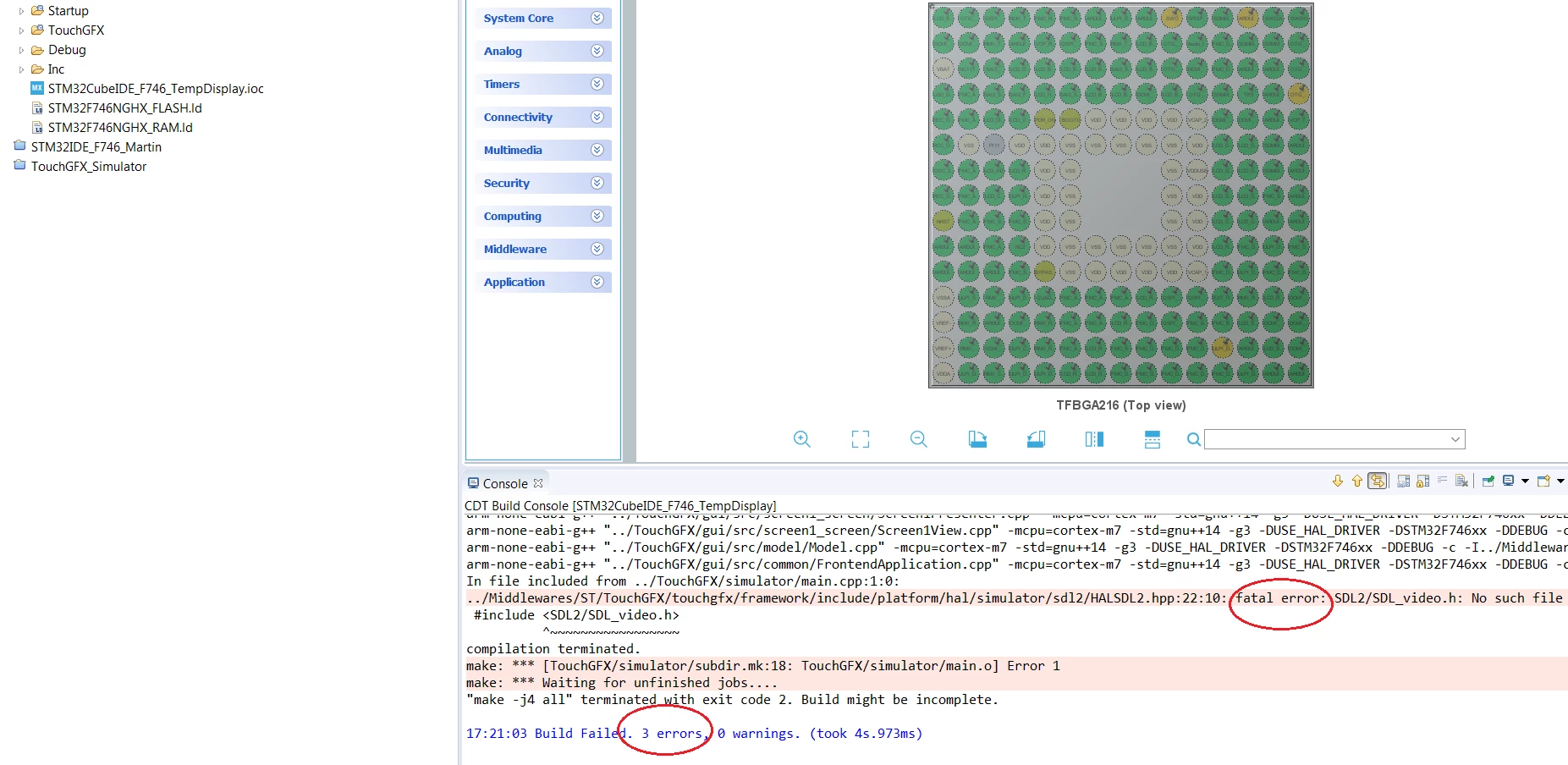

KMunj
KMunjAuthor
May 24, 2019
​Now I opened the windows task manager and killed the IDE.
I reopened the IDE and built the project again. This time it didn't get hung up, but got 3 errors.
Thanks
Kiran
Martin KJELDSEN
Principal III
May 24, 2019
You have not excluded the simulator folder from compilation. I think CubeIDE/CubeMX reset / overwrote your local project changes if you re-generated code. You probably weren't getting those errors the first time around.
