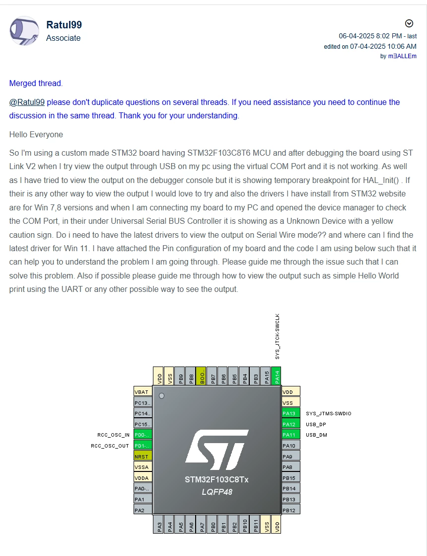

Greeting Everyone,
I am facing an issue with my STM32 board having STM32F103C8T6 as MCU, while trying to see a normal "Hello World" output. After debugging the board, I attempted to connect it to my PC via the serial port. To ensure proper communication, I installed the necessary Virtual COM Port drivers from the STM32 website.
However, my PC is not detecting the COM port to which the STM32 board is connected. Additionally, when I try to view the output on the Debugger Console within STM32CubeIDE, I encounter an error that prevents me from seeing the expected output.
I have written the code below that I'm using to print the Hello World which I have found online. Also I do not know if their is any problem on the code. With this I have also attached the Pin Configuration and Clock configuration details below as images.

Hello @Ratul99 and welcome to the ST Community,
What board are you using? ST board? Custom board? blue/black pill board? and how did you connect the board to a PC with a detailed hardware description.
Thank you

Hello @mƎALLEm
Thank you for the response. As you have asked we are using a custom board and for the debugging part we have used ST Link V2. If anything more details needed please feel free to ask.

Andrew Neil
April 5, 2025
Then please post the schematic.

mƎALLEm
April 5, 2025
You did the printf retarget to the ITM not to the serial port.
ITM_SendChar((*ptr++));
Look at this example for STM32CubeF1 package:
https://github.com/STMicroelectronics/STM32CubeF1/tree/master/Projects/STM32F103RB-Nucleo/Examples/UART/UART_Printf
Look also at this thread: https://community.st.com/t5/stm32cubemx-mcus/how-to-retarget-printf-on-uart/td-p/380053

Andrew Neil
April 5, 2025
Before adding the complexities of printf redirection, be sure that you can get basic direct UART IO working first.

Tesla DeLorean
Guru
April 5, 2025
The ITM would come out of PB3 SWO via the SWV Viewer in STM32 Cube Programmer or your debugger.
The standalone ST-LINK/V2 doesn't provide a USART via a VCP
For your F103 to provide a VCP you'd need to compile as a USB VCP Device and communicate with that and not the USART, but wouldn't really allow for the type of blocking in-line interaction you're attempting.
Consider a cheap USB to CMOS Serial dongle for USART comms
