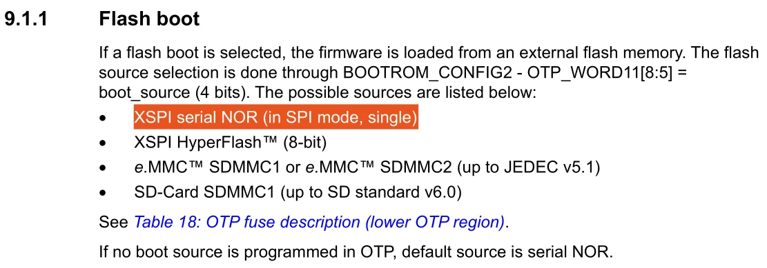

Most of this info is from the
No boot source is programmed in OTP default source is serial NOR

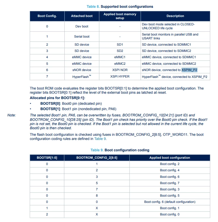

No configuration needed

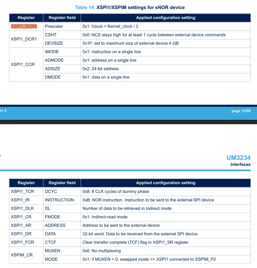

Default settings for the XSPI from the ROM

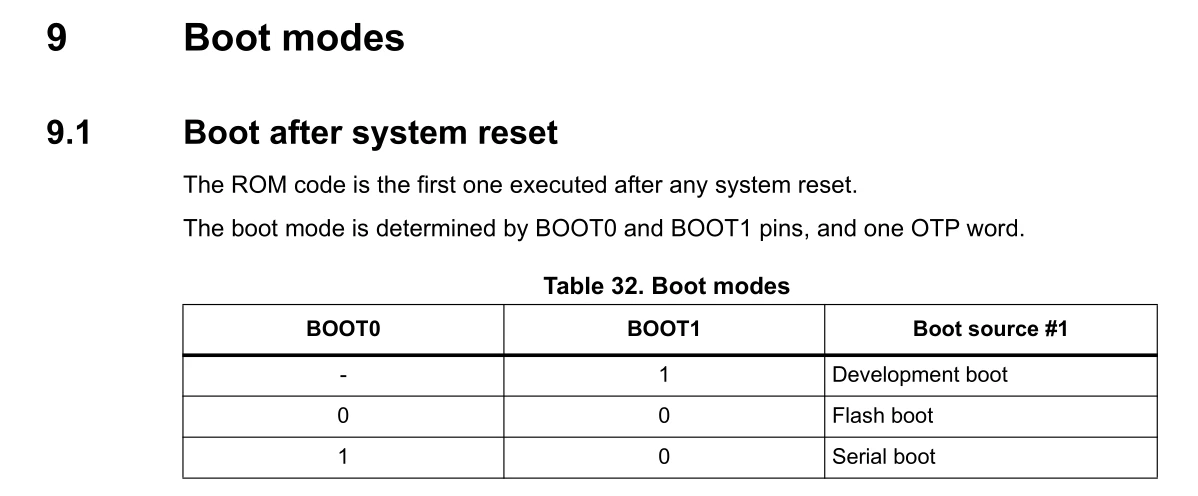

Flash is the boot when Boot1 (low) Fairly curtain thats sNor flash.

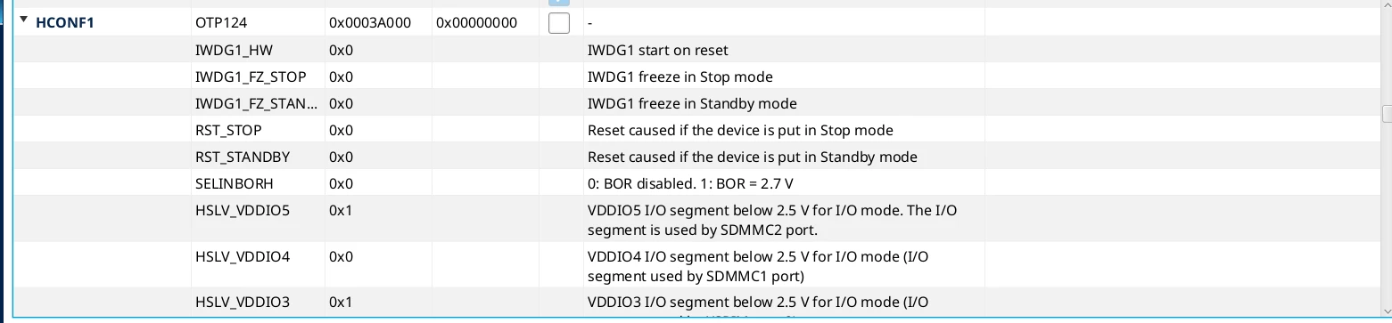

Another good register to have is
  • HCONF1 - OTP124
If you've system is using any 1v8 on any of the VDDIO lines you should set these registers.  Else you might not be able to boot from flash from your FSB because the FSB set the frequency of the spi to fast for it to boot when the configuration is set for a 3v3 line.

bootrom configuration table
* BOOTSR == boot rom switches

Hello @Brenden_PLUS
Your understanding is correct.
By default, in Flash_Boot mode (BOOT0 = BOOT1 = 0), the STM32N6 BootROM configures XSPI1 on Port 2 in single‑SPI mode with the parameters defined in Table 14 of UM3234. This allows the system to boot and copy a signed FSBL binary into the internal AXISRAM2.
Afterwards, depending on the external NOR Flash memory you plan to use, the final configuration must be performed in your FSBL using the External Memory Manager middleware.
