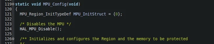

I'm trying to create a project for stm32h7s7 with external loader. But when i added the external loader in IOC file the all indexes were lost in editor mode. But I checked for building, i can't see any problem. I tried index -> rebuild but it could not help me

I'm not able to reproduce the issue with STM32CubeMX 6.16.0 , STM32CubeIDE 2.0.0  and STM32Cube FW_H7RS V1.3.0 Cube firmware .
Could you please update your toolchains and the STM32CubeH7RS firmware versions and let me know if the issue is solved or not?

I'm using the STM32CubeIDE 1.17.0 (on Linux) perhaps the version couldn't support it. I will install the latest version and i ll give a result to you.

Actually i installed the latest version of the CubeIDE and the issue fixed. But the ioc files cant editable in the IDE hence i dont like the new version of the IDE.
