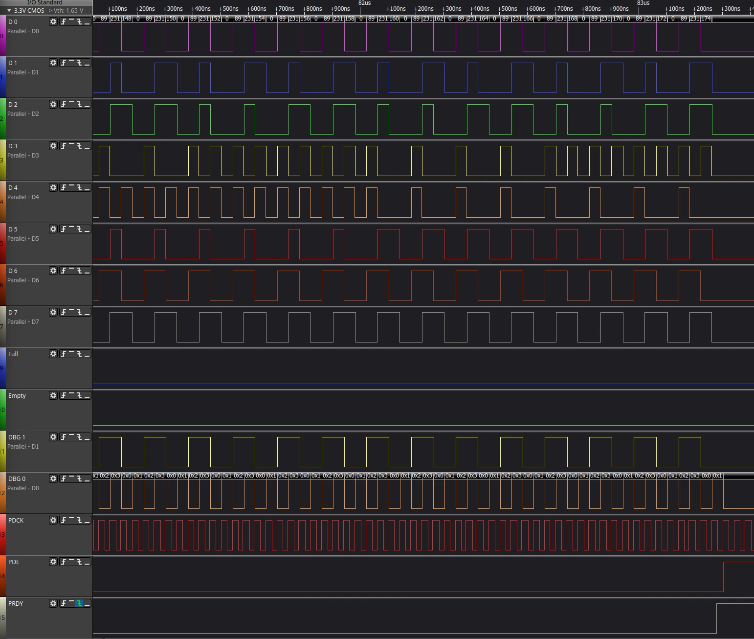

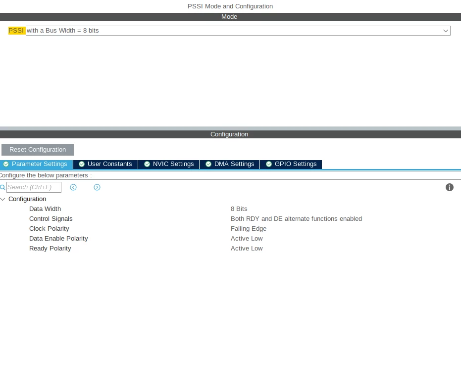

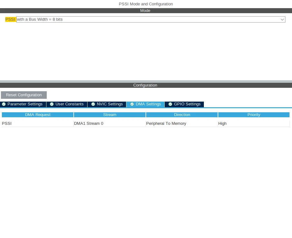

I'm trying to use the PSSI bus in slave mode to transmit data from a small FPGA. After some time chasing a weird bug (I'm losing 8 32bit words at the end of packet) I decided to use a logic analyzer on the bus and it showed a weird behavior from the stm32.
Code configuration:
The code is called in a loop with a flag reset in the transfer callback complete:

if(HAL_PSSI_Receive_DMA(&hpssi, (uint32_t*)tbuf , 512)!= HAL_OK) {

if(HAL_PSSI_Receive_DMA(&hpssi, (uint32_t*)abuf , 512)!= HAL_OK) {

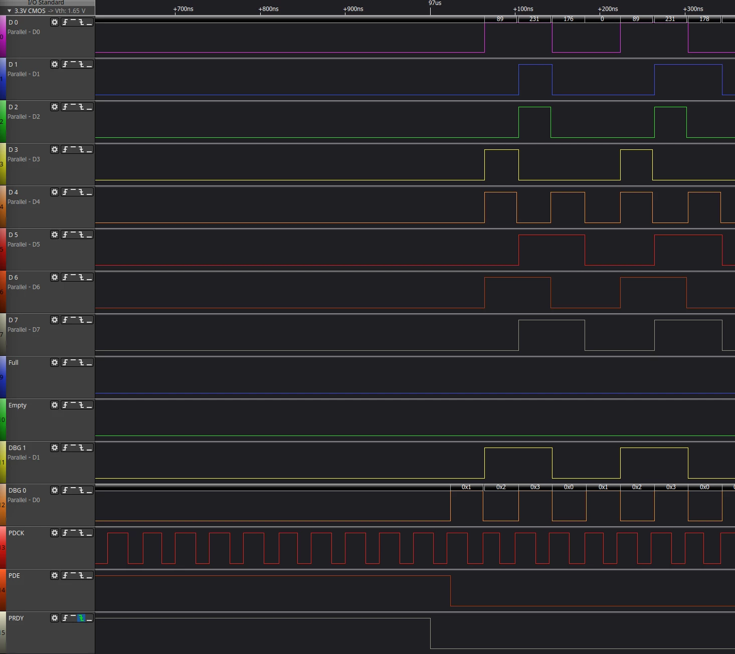

At the begins of the first valid buffer the USB data and the bus capture are aligned:

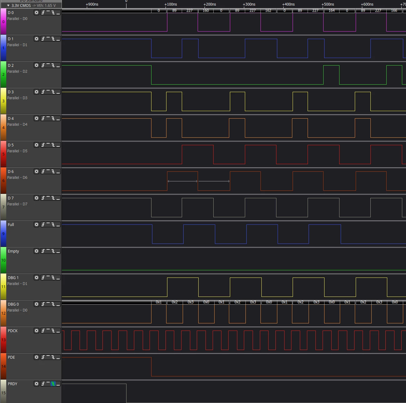

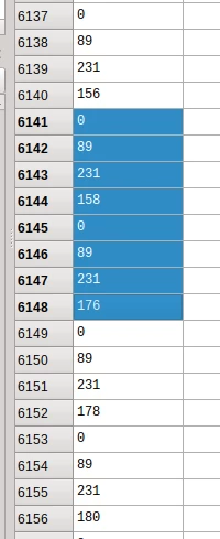

But at the end of the first buffer there is a loss of 8*sizeof(uint32_t) => 32 byte.
We can see on the capture that those missing byte are transferred through the bus and dropped and the begins of the next packet align.
While looking at the full packet length it appears why we have that results. The total valid time of PRDY signal is 83.28us, knowing the clock runs at 25MHz (period of 40ns) it means there are 2082 cycle of PRDY valid, removing the first cycle (where PDE is not asserted) and the last cycle discarded (I repeat this one later) it makes 2080 cycle. If we take an expected length of 2048 cycle and add the 32 missing byte it reaches 2080 cycle.
For now I can lock in FPGA the length to 2048 and hope for the PRDY to go low but it's not a good solution. Maybe I'm doing something wrong, do you have any idea of why this behavior and what I may be doing wrong ?

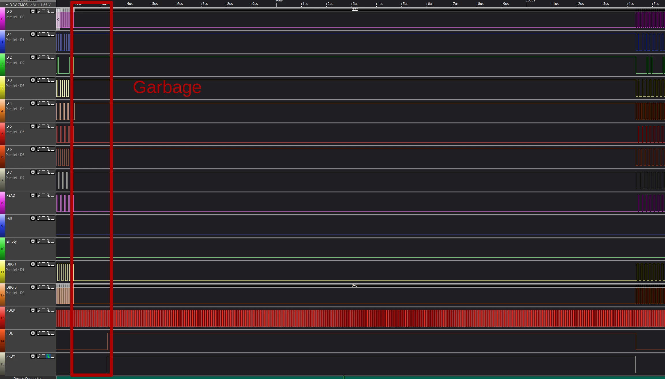

For now I added a workaround allowing me to continue working on this project.
Deasserting data enable doesn't help, PRDY is still enabled no matter what. So I basically send garbage and stale my FIFO as soon as PRDY is asserted for more than 2048 cycle and until next PRDY cycling.

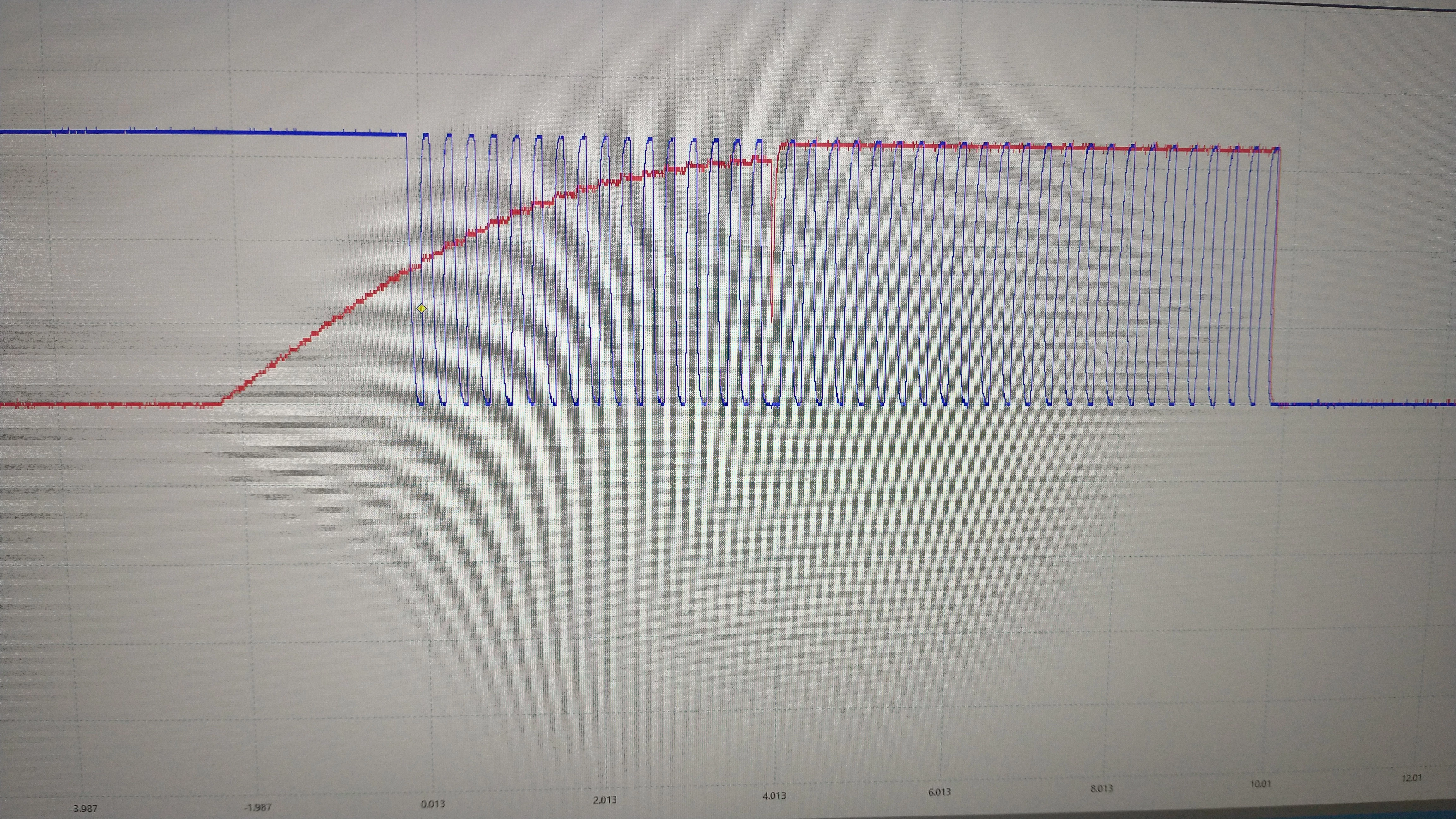

I also saw weird spurious content on my RDY signal in addition to the FIFO bug!
I stuck a picture of the worst case behavior that I captured. In my case it was due to a weak pullup on the output pin of the ICE40 FPGA I had on the other end of the interface. When the HAL_ library disables the interface and blanks the FIFO, it also releases drive on the IO pin allowing it to float. I solved this by disabling the pullup on the ICE40 output, and enabling a pulldown on the STM32 RDY input.
You can prevent the FIFO bug too, by simply commenting out the "HAL_PSSI_DISABLE(hpssi);" at the top of the read function. Does this fix go away every time you regenerate the code? yes. Should I open a issue against the github for the HAL_ library? probably. Has this allowed me to get rock solid PSSI operation out of my part? Also yes.
