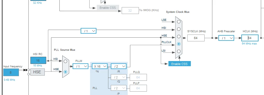

1- You are using HSI as clock source for FDCAN which is not recommended:
Please use STLINK MCO as clock source for the MCU (HSE in Bypass mode) with frequency input set at 8MHz:
2- Why are you setting FDCAN clock (64MHz) > System clock (32MHz)?
The FDCAN requires that the CAN time quanta clock is always below the APB clock. Please read this article: FAQ: Fixing STM32 FDCAN communication disruptions - APB bus, kernel, and time quanta clocks

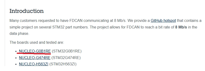

I invite you to refer to this knowledge base article: STM32 FDCAN running at 8 Mb/s on NUCLEO boards
 NUCLEO-G0B1RE board was already used:
The project is in this Github hotspot.
Hope that helps.
