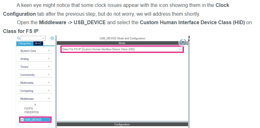

I'm following the instructions at:
How to implement a USB device custom HID class on ... - STMicroelectronics Community
Part way down it suggests:

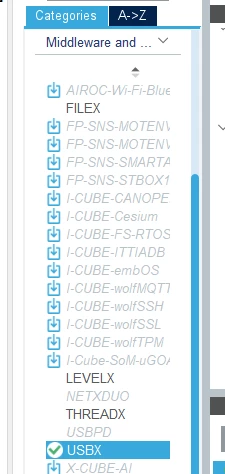

However when I got to Middleware I don't have USB_DEVICE (I just have USBX)
I can't see a way to add the USB_DEVICE Package to to the middleware list.
Help (please)?

I've come across the post:
USB_DEVICE missing from CubeMX - STMicroelectronics Community
This suggests the instructions linked in the top post are out of date. Is there an up to date guide/tutorial for implementing a custom USB HID device on a Dev Kit/Demo Board?

Hi @BenG
STM32H5 natively supports USBX not legacy library. So CubeMX doesn't support ST classic library. Check this repository for ready to use examples based on classic middleware over H5.
