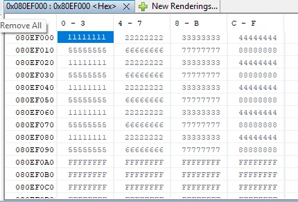

Hi all, attempting to write data to a specific address in flash bank 1 and calculate the CRC. Using three different CRC methods: flash CRC, software CRC, and hardware CRC, but getting three different values for the same data. The code is attached below. Additionally, the read and write operations are functioning correctly. Could anyone help identify what the issue might be?

#define FLASHADRESS 0x080EF000
#define crcendadress 0x080EF09C

void flashcrccalculation(void) {
	uint32_t result = 0U;
	uint32_t result2 = 0U;
	uint32_t result3 = 0U;
	size_t value = 0U;
	HAL_FLASH_Unlock();
	FLASH_CRCInitTypeDef crccalculator={0};
	crccalculator.TypeCRC = FLASH_CRC_ADDR;
	crccalculator.Bank = FLASH_BANK_1;
	crccalculator.BurstSize = FLASH_CRC_BURST_SIZE_4;
	crccalculator.Sector = FLASH_SECTOR_7;
	crccalculator.NbSectors = 1;
	crccalculator.CRCStartAddr = FLASHADRESS;
	crccalculator.CRCEndAddr = crcendadress;
	HAL_FLASHEx_ComputeCRC(&crccalculator, &result);
//	result^= 0x55555555;
	UART_printf("%x\n", result);
	value = 50*4*8;
	result2 = SW_crc32_Calcul(FLASHADRESS, value, 4);
	UART_printf("%x\n", result2);
	result3 = HAL_CRC_Calculate(&hcrc, data, 50);
//	result3^= 0x55555555;
	UART_printf("%x\n", result3);
	HAL_FLASH_Lock();
