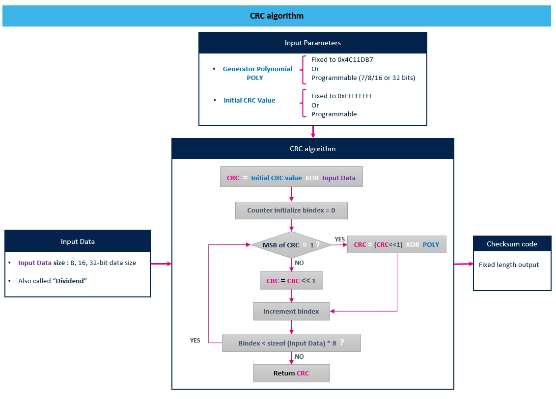

• Initial CRC value
At start up, the algorithm sets CRC to the initial CRC value XOR with the dividend.
Once CRC MSB is equal to one, the algorithm shifts CRC one bit to the left and XORs it with the generator polynomial.
Otherwise, it only shifts CRC one bit to the left.
Figure below describes the algorithm used in STM32 MCUs.

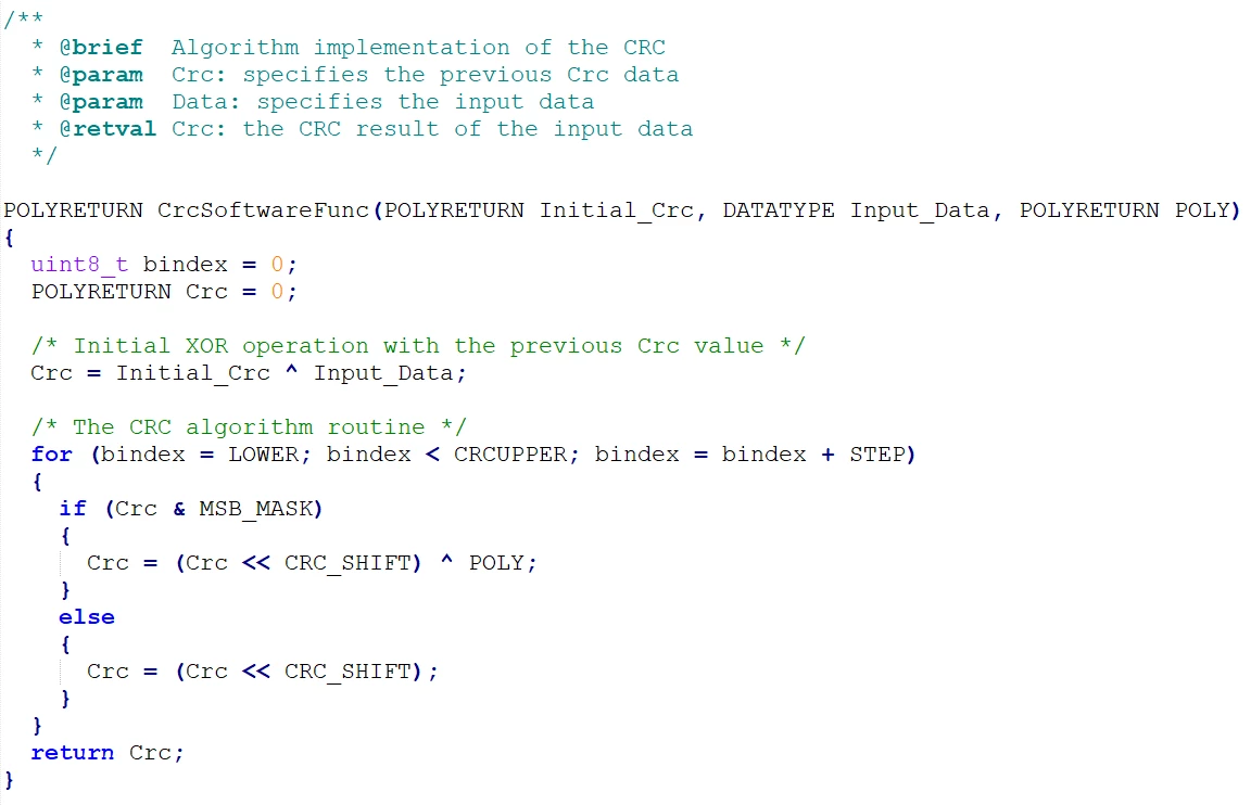

The embedded software gives a computation example of CRC. The algorithm implementation by software is developed in the function CrcSoftwareFunc:

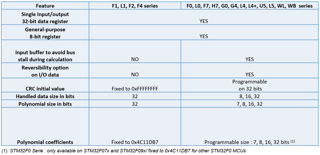

3. What are CRC features in STM32 MCUs?
CRC peripheral features vary from one STM32 to another, meanly are listed below:
If the feature “Reversibility option on I/O data” is enabled, each input and/or output byte is reflected before being used in the calculation. Bits of the input or/and output byte are used in reverse order.
See the devices Reference manuals for detailed use of the CRC functionality.

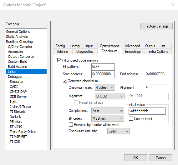

  • With IAR EWARM Toolchain
IAR EWARM provides a way to generate checksum in Project--> Options:

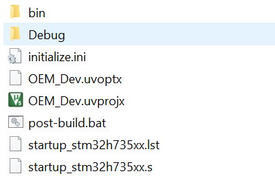

  • Copy srec_cat.exe, srec_cmp.exe, and srec_info.exe files in a new “bin” folder to the root of a Keil project as shown below.

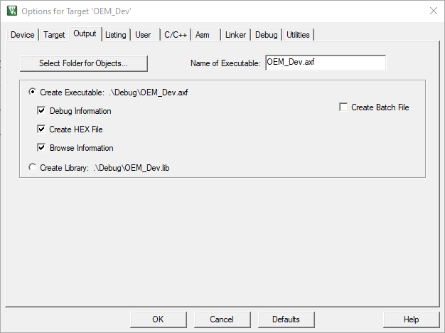

  • Enable the option “Create HEX file” in tab “Output” of Options:

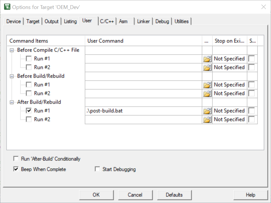

  • Enable the post-build option
To add a CRC after build, it is necessary to enable option “After Build/Rebuild” in User tab and call Srecord commands:

  • Save your file as “post-build.bat”.
  • Enable post-build option and call this file:

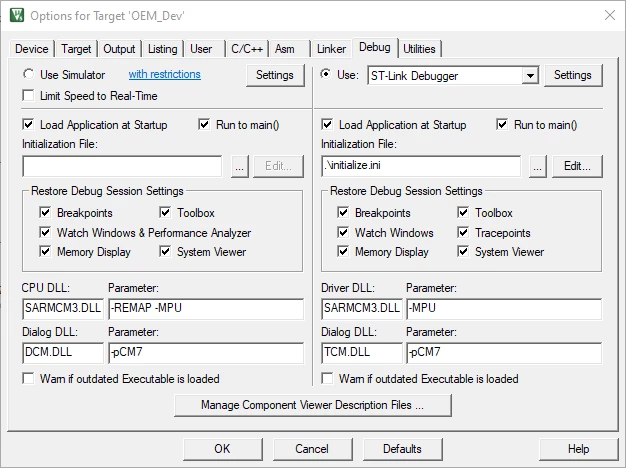

  • The hex file to be used for debug and download must be filled in Debug tab.
The edited hex file generated in post-build step will be then used for programming and debugging.

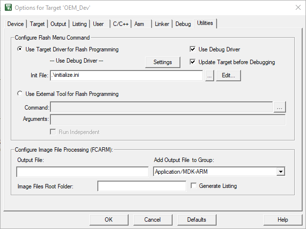

Create a text file, rename it as “Initialize.ini” for example and save it in the root of the project.
Write this command to the file and save it: LOAD .\debug\ OEM_Dev_CRC16.hex INCREMENTAL
Enter this file in Debug tab:
And in “Utilities” tab:
