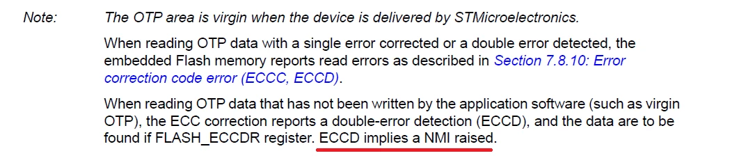

So first check if you have Flash ECCD (double ECC error) errors detected:

 // If the error is caused by an unprogrammed OTP read:
 if ((error_address >= 0x08FFF000) && (error_address <= 0x08FFF7FF)) {
 SEGGER_RTT_printf(0, "Virgin OTP read error detected!\n");
 Thank you!

Why would I have this type of error?
Maybe you written to the Flash without erasing it.
Also refer to this article pointed out by @Sarra.S
February 17, 2025
Hello @massimoperdigo,
Also, from searching the RM0481, NMIs are linked to 3 cases:
  1. Flash ECC double error: check Handling ECC errors in STM32H5 series: Reading unw... - STMicroelectronics Community
  2. If an HSE clock failure occurs when the CSS is enabled, the CSS generates an interrupt that
    causes the automatic generation of an NMI (since you're not using HSE, I guess this one is eliminated)
  3. System configuration, boot, and security (SBS)
In each case, you need to monitor the status of the relevant registers when the NMI occurs!
Also, you can check this article in case you'll be using MPU in the future: How to avoid a HardFault when ICACHE is enabled on... - STMicroelectronics Community
