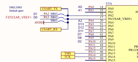

On nucleo64 the onboard st-link uart is here ->
Jun 2, 2025 8:25 AM UTC
My PA2/PA3 are already set to USART_TX/USART_RX respectively.
What's the content of "myUART.h"? I don't have such a header.
There's no int _write(int, char*, int) function in my codebase either. Should I define it myself?
AScha.3
