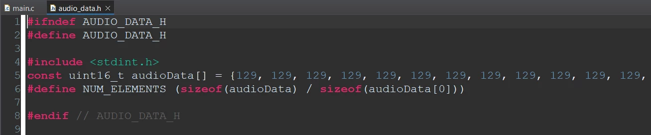

The PCM data ranges from 0-255 that is it's 8bit data
Indeed, very low data range scale vs the full scale of the timer counter/CCR which are 16-bit.. If you multiply these values by 256 (to amplify the values)? what happens?

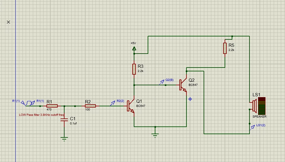

YatoAuthor
June 21, 2024
I am using a 8ohm speaker. I know that the stm32 has limitation of 3.3V and I am using two stage amplifier (you may see the circuit in the other comment I have replied to). I am using GPIO pin PA0

I am using tim2 ch1 for pwm generation , the pin I am using is PA0 but I also tried with PC6 that is tim8 ch1. The main issue is that I am getting less then 1V on signal output (GPIO Output)
Just for references I tried the same algorithm with another Microcontroller (not STM) with 5V output voltage using the same data the loudness was excellent. I mean even if we go by the logic that STM32 has 3.3V output Voltage
Sorry, but how you did measure the IO pin voltage? during the PWM generation? I think your data does not reach the full scale of your 16 bit timer as you are using the same data from a 5V MCU. You need to adapt your data according the STM32 timer.  Maybe you need to amplify your signal in your lockup table.
Peter BENSCH
June 21, 2024
In addition to that: your amplifier circuit is a simple double inverter, where you can omit the second stage and connect the speaker directly to Q1. Q2 has no advantage, only the disadvantage that you permanently connect the speaker to 5V when the PWM output is inactive, which dynamic speakers don't like at all.
To remove the DC offset of the PWM signal, you should provide a capacitive coupling and also connect a real audio amplifier, e.g. the TS4871. In its data sheet you will find an example schematic that already contains the capacitive coupling mentioned above.
