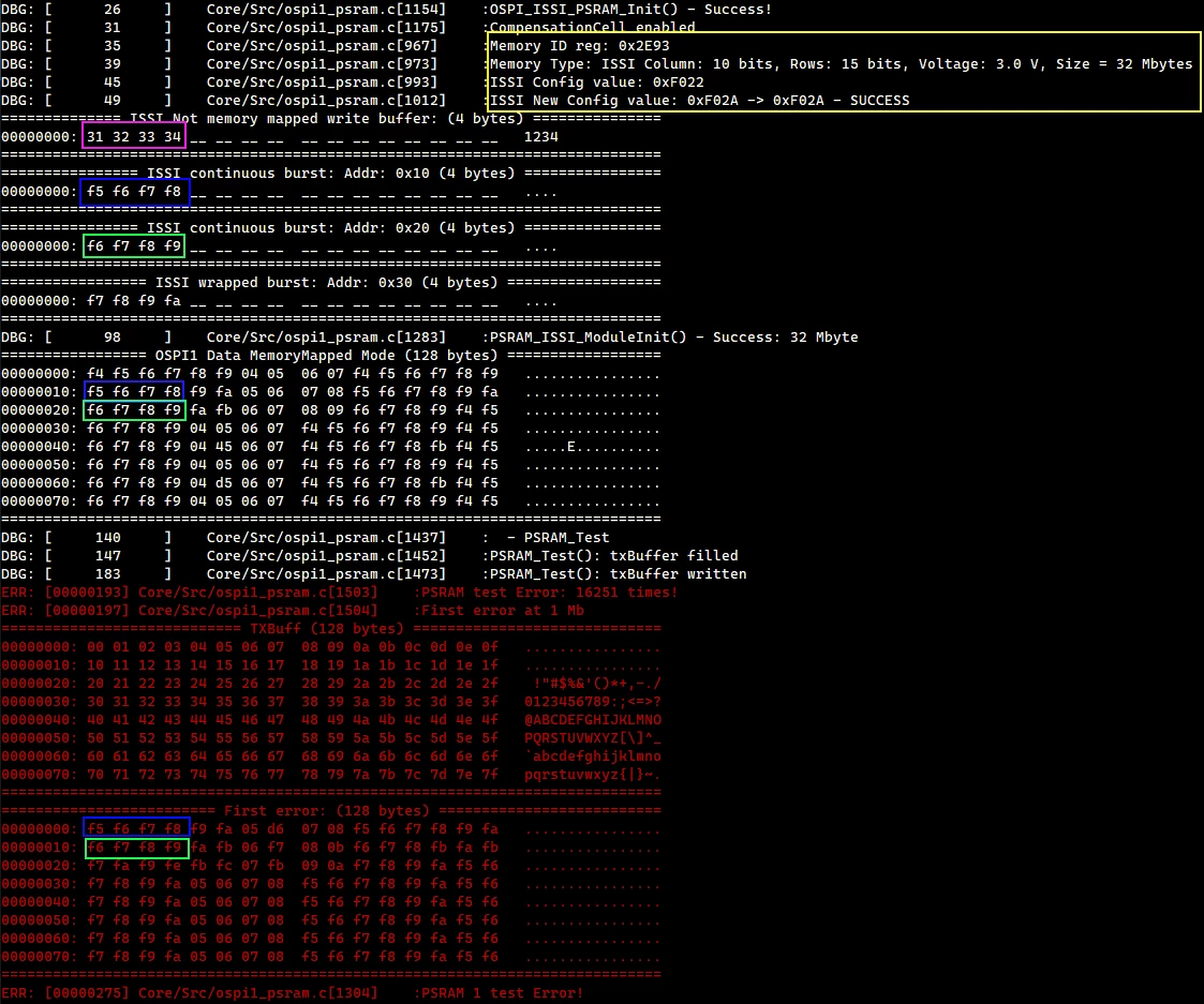

Hi All!
I try to use 2 pieces of IS66WVO32M8 PSRAM with multiplexed OSPI ( only the NSS pins not shared ) with STM32F585 in memory mapped mode.
Previously, I used 2 pieces of APMemory's APS12808L in memory mapped mode without any issues.
I reconfigured all the necessary parameters to IS66... according the datasheets (AN5050, STM32F585 OSPI errata), and other's suggestions in the forum, like:
https://community.st.com/t5/stm32-mcus-products/problem-with-psram-peripherals-of-stm32h735/m-p/706406#M257198
or
https://community.st.com/t5/stm32-mcus-products/problem-with-psram-peripherals-of-stm32h735/td-p/706406

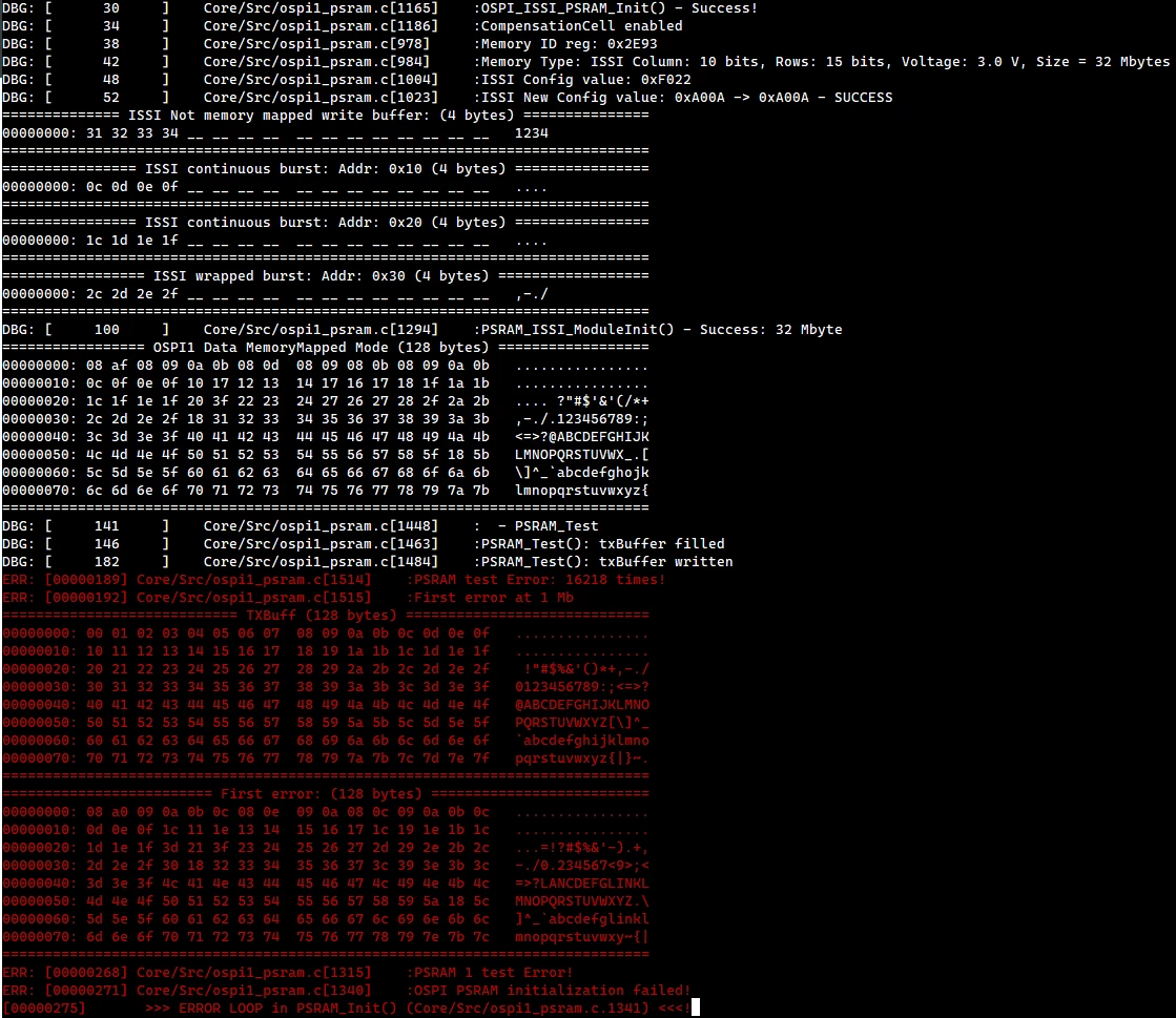

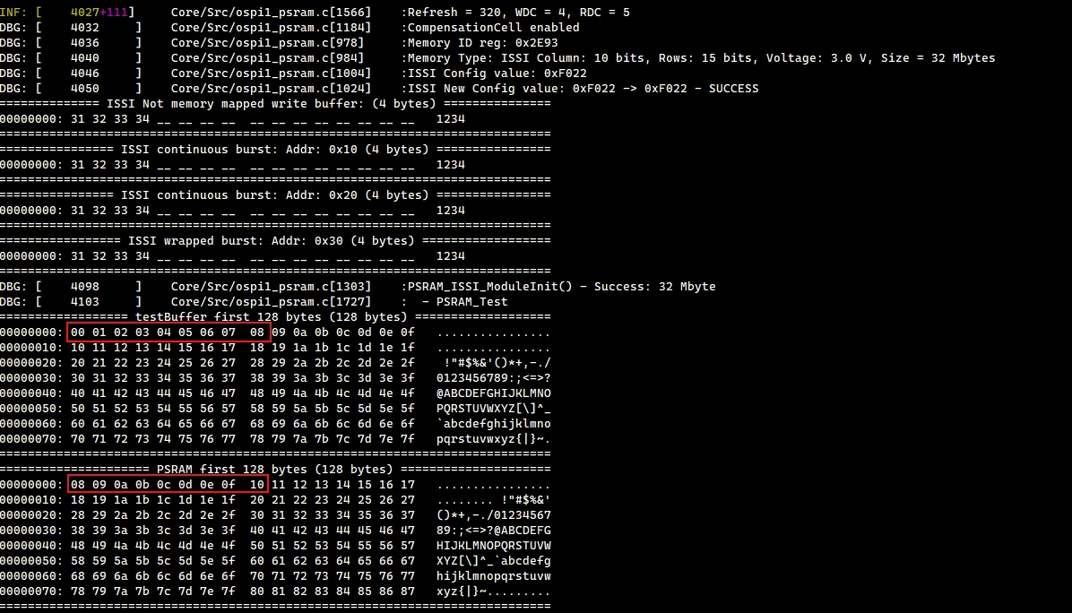

I can read the ID and configuration registers, I can also modify them (Yellow square), but when I write directly or indirectly to the memory area, and read back for verification, it causes an error.
I tried to change the OSPI speed, using 55, 80, 100 MHz (with recalculated refresh rate using 4us tCEM:  220, 320, 400, 640), with- or without delay block, DHQC enabled/disabled (I know the errata), and DQS values, etc., but didn't work, except that some settings were totally wrong for configuration registers.
I don't know exactly what the error is: writing to memory area or reading it.
My biggest success is that I can read the same data from the same address in both memory mapped mode and normal mode (blue and green squares), but this data is not the same as what I wrote (pink square).
There is someone who configured and use successfully this type of PSRAM ?
Maybe I missed something ?

 if (ISSI_ReadReg(hospi, ISSI_READ_CFG, 0x00000000, (uint8_t*)(&id), 2 ) == HAL_OK)
 Debug("Memory ID reg: 0x%04X\n", id);
 if ((id & 0x0F) == 0x03 ) // ISSI
 size = (1 << (((id >> 4) & 0x0F)+1)) * (1<<(((id >> 8) & 0x0F)+1)) ;
 Debug("Memory Type: ISSI Column: %d bits, Rows: %d bits, Voltage: %s V, Size = %d Mbytes \n",
 ((id >> 4) & 0x0F)+1,
 ((id >> 8) & 0x0F)+1,
 (id >> 13) == 1?"3.0":"1.8",
 size / 1024 / 1024
 // Read and modify configuration register
 if (ISSI_ReadReg( hospi, ISSI_READ_CFG, 0x00040000, (uint8_t*)( &regVal ), 2 ) == HAL_OK)
 /* ISSI configuration register
 default: 0xF022
 F0 = 1 111 000 0 : Noraml op, 24Ohm, Reserved, DQSM: 0
 22 = 0010 0 0 10 : Latency: 5Clock, Variable, 32 burst len
 1111000000100010
 1111000000001010
 Debug("ISSI Config value: 0x%04X\n",regVal);
 regVal |= (1<<3); // Fix latency
// regVal &= ~(0x70); // Latancy code: 3 cycle
 // Check the write was success
 if (ISSI_WriteReg( hospi, ISSI_WRITE_CFG, 0x00040000, (uint8_t*)( &regVal), 2 ) == HAL_OK)
 uint16_t newRegVal = 0;
 ISSI_ReadReg( hospi, ISSI_READ_CFG, 0x00040000, (uint8_t*)( &newRegVal), 2 );
 Debug("ISSI New Config value: 0x%04X -> 0x%04X - %s\n",
 regVal, newRegVal, newRegVal == regVal?"SUCCESS":"FAIL");
 else
 ERROR("ISSI reRead Configuration Error!\n");
 else
 ERROR("ISSI Read Configuration Error!\n");
 // Read preamble register value
 if (ISSI_ReadReg(hospi, ISSI_READ_PATTERN, 0x00000001, (uint8_t*)( &regVal), 2 ) == HAL_OK)
 Debug("ISSI Preamble Pattern: 0x%04X \n", regVal);
 else
 ERROR("ISSI Read Preamble Error!\n");
 hexdump("ISSI Not memory mapped write buffer:",regW_MR0,4);
 // Test conventioanl (direct) SPI transfer to memory
 if (ISSI_WriteReg( hospi, ISSI_WRITE_COMMAND, 0x00000010, regW_MR0, 4 ) == HAL_OK)
 if (ISSI_ReadReg( hospi, ISSI_READ_COMMAND, 0x00000010, regR_MR0, 4 ) == HAL_OK)
 hexdump("ISSI continuous burst: Addr: 0x10",regR_MR0,4);
 if (ISSI_WriteReg( hospi, ISSI_WRITE_COMMAND, 0x00000020, regW_MR0, 4 ) == HAL_OK)
 if (ISSI_ReadReg( hospi, ISSI_READ_COMMAND, 0x00000020, regR_MR0, 4 ) == HAL_OK)
 hexdump("ISSI continuous burst: Addr: 0x20",regR_MR0,4);
 if (ISSI_WriteReg( hospi, 0x0000, 0x00000030, regW_MR0, 4 ) == HAL_OK)
 if (ISSI_ReadReg( hospi, 0x8000, 0x00000030, regR_MR0, 4 ) == HAL_OK)
 hexdump("ISSI wrapped burst: Addr: 0x30",regR_MR0,4);
 return size / 1024 / 1024;

 hospi->Init.Refresh = 320; //640; //320 -> //
 Refresh value:
 OCTOSPI Clock period x Refresh = tCEM
 160MHz = 0,00000000625 sec
 100MHz = 0,00000001 sec
 80MHz = 0,0000000125 sec
 55MHz = 0,0000000182 sec
 4 us = 0,000004 sec
 8 us = 0,000008 sec
 Refresh = tCEM / Clock -> 640
 4 us @ 80MHz -> 320
 4 us @ 100MHz -> 400
 4 us @ 160MHz -> 640
 8 us @ 80MHz -> 640
 8 us @ 160MHz -> 1280
 4 us @ 55MHz -> 220

Hello @ccuebler ;
Could you please check the dummy cycle?
Is the cache enabled?
For CPU accesses, try to enable ICACHE and/or DCACHE, and configure the OCTOSPI memory as cacheable (CACHE only performs 32-bit read accesses).
I hope this help.
Thank you.
Kaouthar

Hello @ccuebler ;
What about the dummy cycle? Does 5 correspond to the value mentioned in the memory datasheet?
Thank you.
Kaouthar
ccueblerAuthor
September 22, 2025
Hello @KDJEM.1
I somehow missed Your question.
I checked again the datasheet of PSRAM, and yes, I only used dummy cycles for read, but it need to writings.
According to the datasheet I'm using 10-10 cycles, and the result is a little closer to My expectations, but not perfect.
In memory mapped mode some data was almost good but not in the right address.
I tried to change the dummy cycles, and refresh time but this was the best result.
About the DCache, You are right, I disabled it last time for a test.
Now, It enabled again in incremental mode
Thank You.

ccueblerAuthor
September 23, 2025
Hi @KDJEM.1
An addition information:
Now, the direct read / write is good with weird values:
   refresh = 320, Write dummy cycle: 4, read dummy cycle: 5
I tried five times with 1024 bytes long buffer, in a different address.
Because it was good, I ran the delay block tuner  (https://github.com/STMicroelectronics/STM32CubeU5/tree/main/Projects/B-U585I-IOT02A/Examples/DLYB/DLYB_OSPI_PSRAM_ExhaustiveTuning)
and I use that values :
dlyb_cfg.PhaseSel = 1;
dlyb_cfg.Units = 50;
I test it, but in memory mapped mode not works properly.
More interesting: The readed data shifted by 8 bytes...
I tried with or without DCache.
Have You any idea?
Thank You
Krisztian

ccueblerAuthor
September 30, 2025
Hi @KDJEM.1
Thank You, but as I mentioned, I ran this "delay block tuner / calibrator".
Finally, we replaced the ISSI to APS25608N (and configure it), and it works, but need to modify the whole product because of the 1.8V power supply.
So, if You or others in ST know the solution, please let me know.
Thank you.
