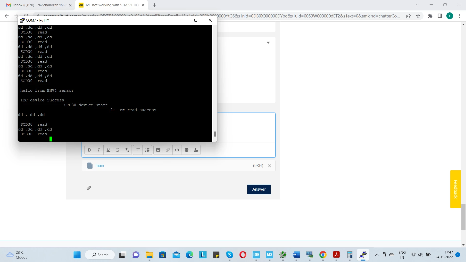

I2C not working with STM32F103C6 and STM32F103C8
we have been trying to get the I2C up on both the controller and no responses from anyone the cubeMx issue if I2C is really a problem..Kindly respond as we are trying to get I2C up ..

RShiv.1
RShiv.1Author
November 24, 2022
added the code for reference
RShiv.1
RShiv.1Author
November 24, 2022
when there are no values and printing only dddd..I used to do the power cycle and then get the version number properly...but here I am not seeing any values.....let me know any change...thanks
RShiv.1
RShiv.1Author
November 24, 2022
I was referring to my earlier code when I had the version number print ON
AScha.3
November 24, 2022
Oo, sensor want/need crc byte also... ****.
RShiv.1
RShiv.1Author
November 24, 2022
I thought initially...but in my earlier I used to get the version number fine without sending 0xC2 as the CRC...well...let me know the change..so that I will try making here...just at the start we shall add or for every SCD30_cnt_measurement[0] = 0xC2 buffer value??
RShiv.1
RShiv.1Author
November 24, 2022
SCD30_cnt_measurement[0]=0xC2;
  SCD30_cnt_measurement[1]=0x00;
  SCD30_cnt_measurement[2]=0x10;
  SCD30_cnt_measurement[3]=0x04; //0x400 = 1020 mbar
  SCD30_cnt_measurement[4]=0x00;
is this the change you are referring??
RShiv.1
RShiv.1Author
November 24, 2022
code reference to check version number also..
..I have added different pattern like..sending stop bit first ..then soft reset..then 2s interval..then firmware...then start...then get ready ...then read....is this pattern correct..do we need to follow this...comparing this with workiing Rpi model we have...let me know your thoughts...
RShiv.1
RShiv.1Author
November 24, 2022
checked with CRC 0xC2..not seeing any change
AScha.3
November 24, 2022
yea.
RShiv.1
RShiv.1Author
November 24, 2022
any other methods to get this???
