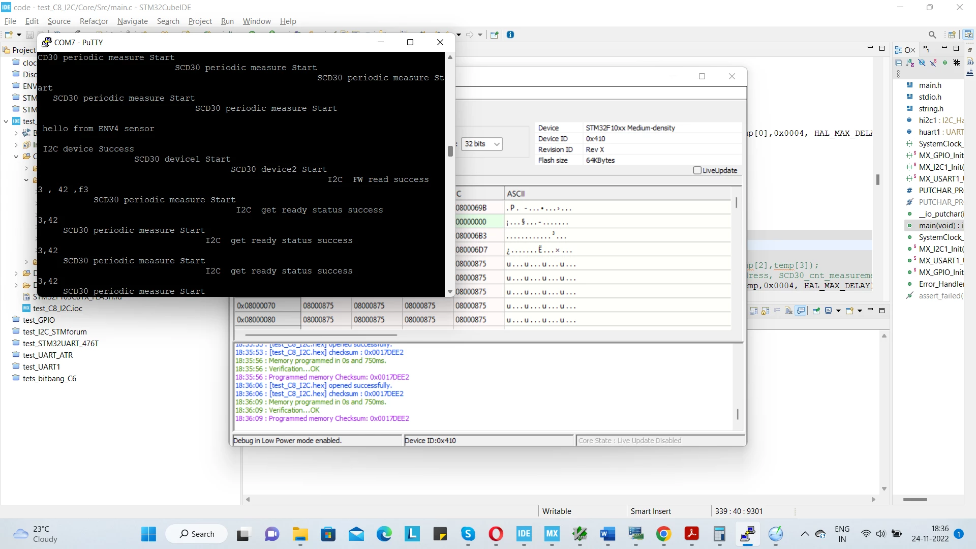

Hi ,
with this code atleast I got version number fine each time...with out CRC..but when I go ahead with periodic measurement...I see change in values...do not from where...

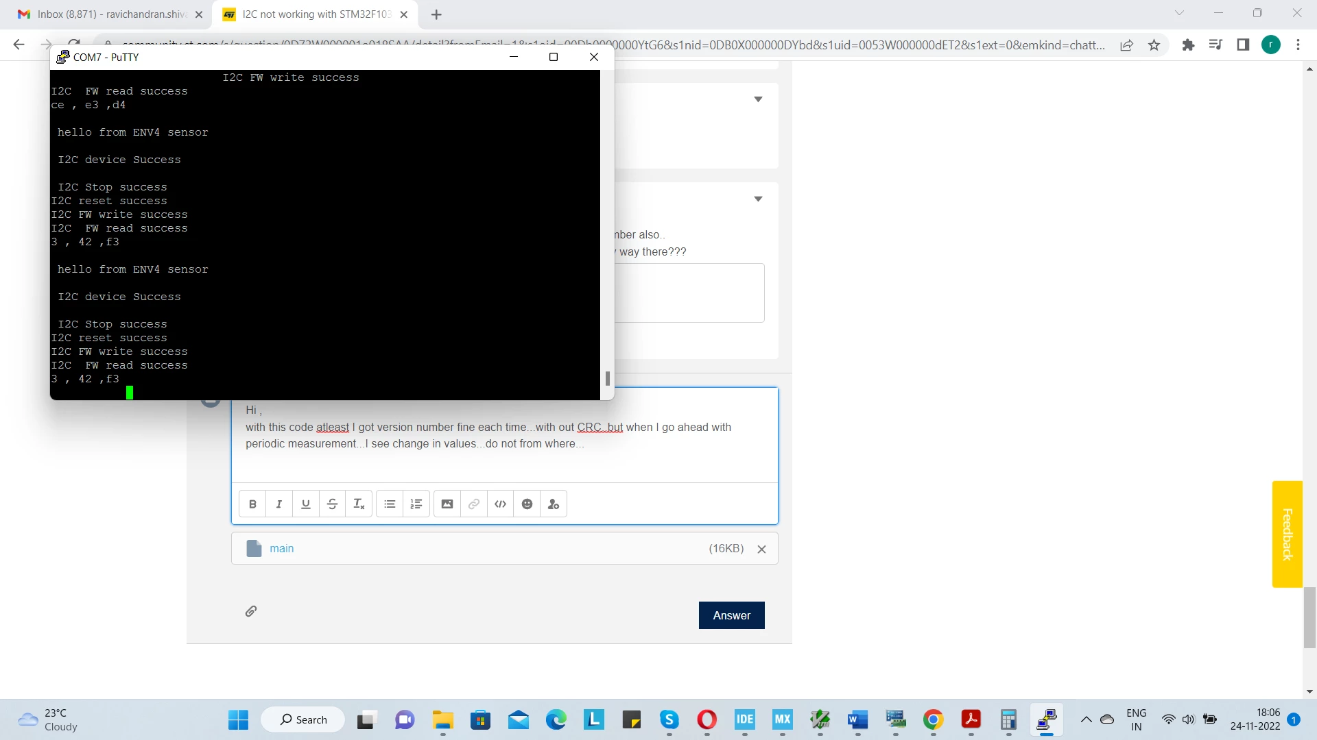

RShiv.1
RShiv.1Author
November 24, 2022
when I flash the previous code I shared with you ..I am able to get the version number..once I had any set interval or periodic measurement...version number values change and also ...periodic measurement fails...not able to understand where the probelm is??
let me know if you get any thought on this...almost close I guess..

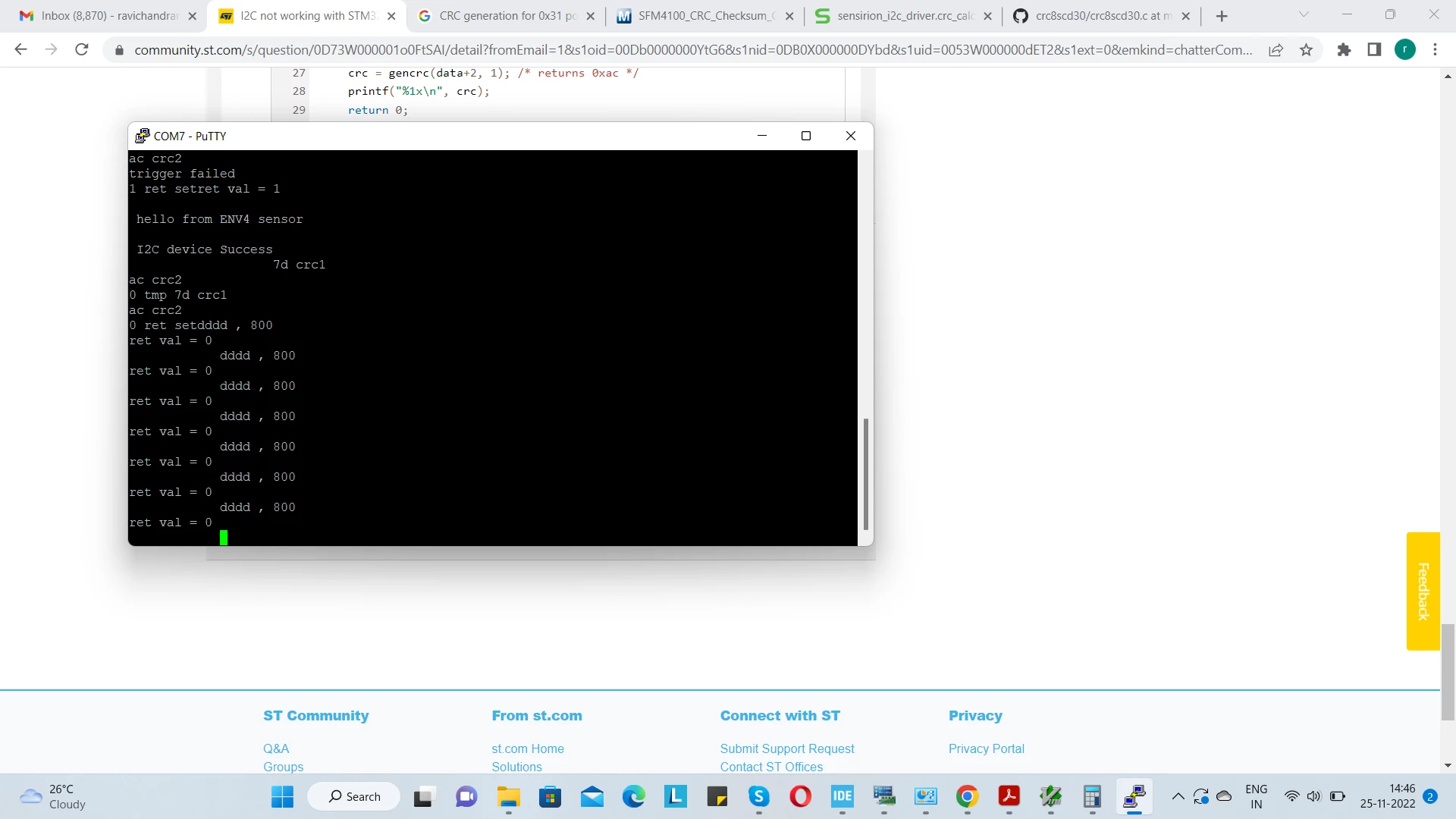

Hi ,
As suggested I generated the CRC and also the start continuous mode ..
looks like CRC is not generating as 9x92 instead getting 0x7d..any error let me know
I am getting data ready flag as 1.....
0693W00000WJV0SQAX.pngregards
Ravi
