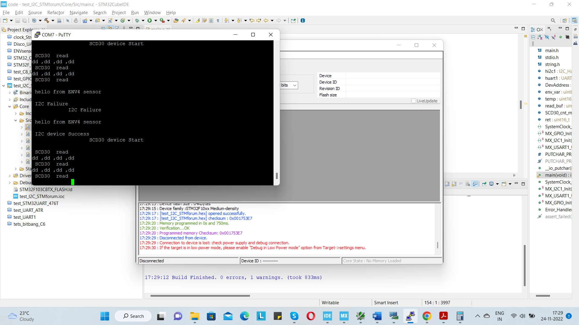

when I do I2C_Mem_write it passes..but not I2C_Master_Transmit??...anyways I am not getting the intended answer in the buffer...thanks

sorry I had updated ...I2C is working fine...and I am also able to get the version of the sensor fine.
After which I am trying to read the status ready ..where I am not seeing the flag .
if I just enable version number all is fine..but when I try to get the get ready flag there seems to be problem...more to do with I2C_Mem_write and Mem_read...any suggestion with the way it is called kindly let me know.
Thanks
Ravi

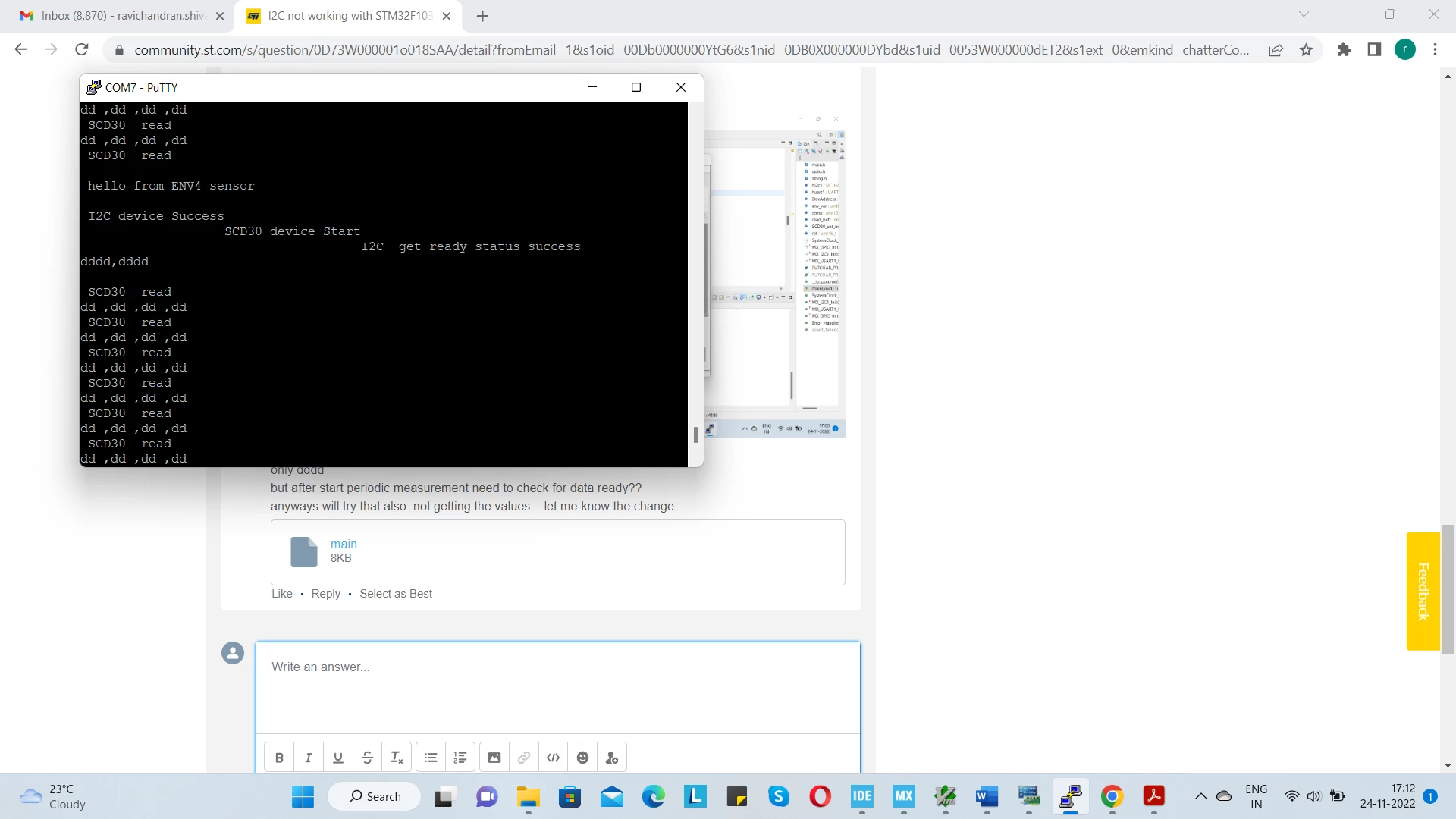

I tried with this which says
only dddd
but after start periodic measurement need to check for data ready??
anyways will try that also..not getting the values....let me know the change

0693W00000WJQdyQAH.pngGet ready status is not seen to check whether sensor is ready to send??..
tried adding that piece of code was well...
any change let me know
thanks and regards
Ravi
AScha.3
November 24, 2022
so no error, sensor and I2C working ok.
did you power cycle?
power off sensor and STM board, wait, then power up again. sensor need power restart...

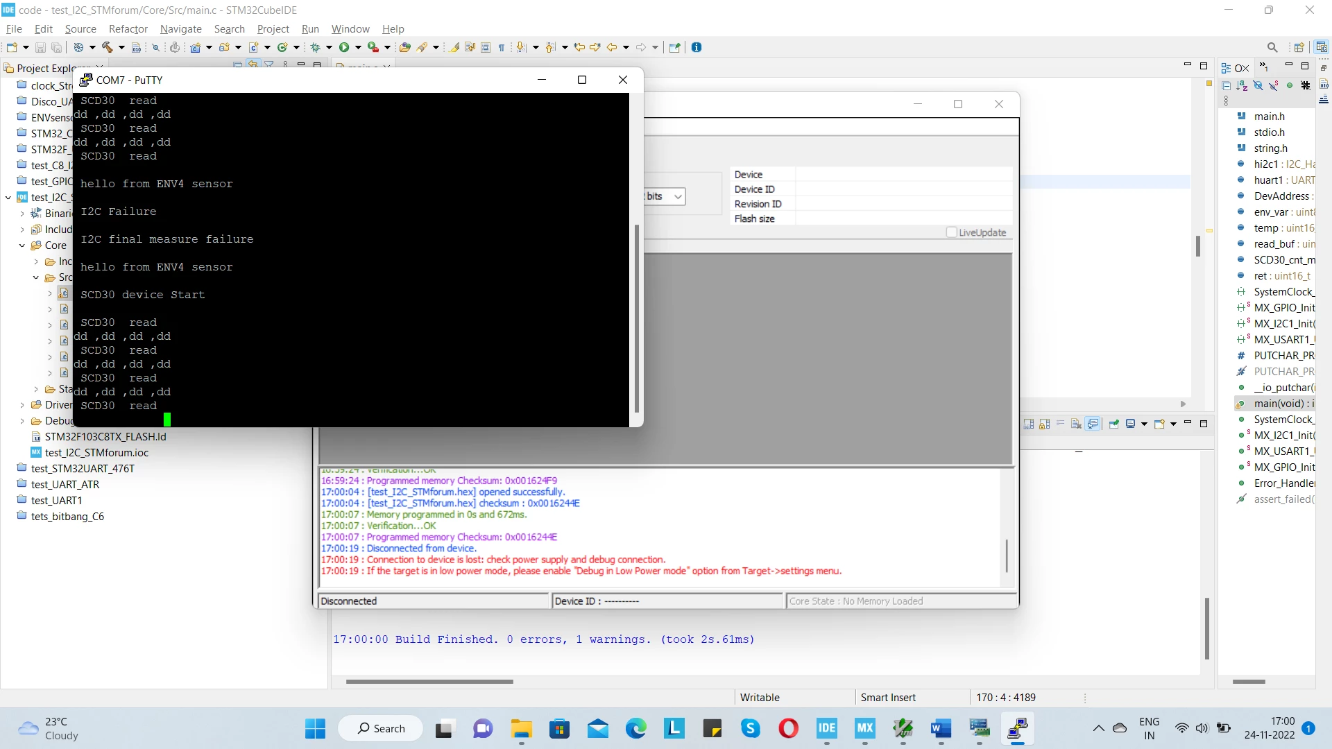

RShiv.1
RShiv.1Author
November 24, 2022
yes I2C is working ..
0693W00000WJQhqQAH.pngdid the power cycle....power off both sensor and STM board...still not getting any values...
