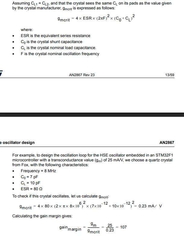

Is it the same behavior as the other thread ?
If yes start by reviewing the compatibility of the crystal by referring to the AN2867 and calculating the gain margin:mALLEm_0-1744619426448.png
Do you get the gain margin > 5 based on what do you have in the HW?
