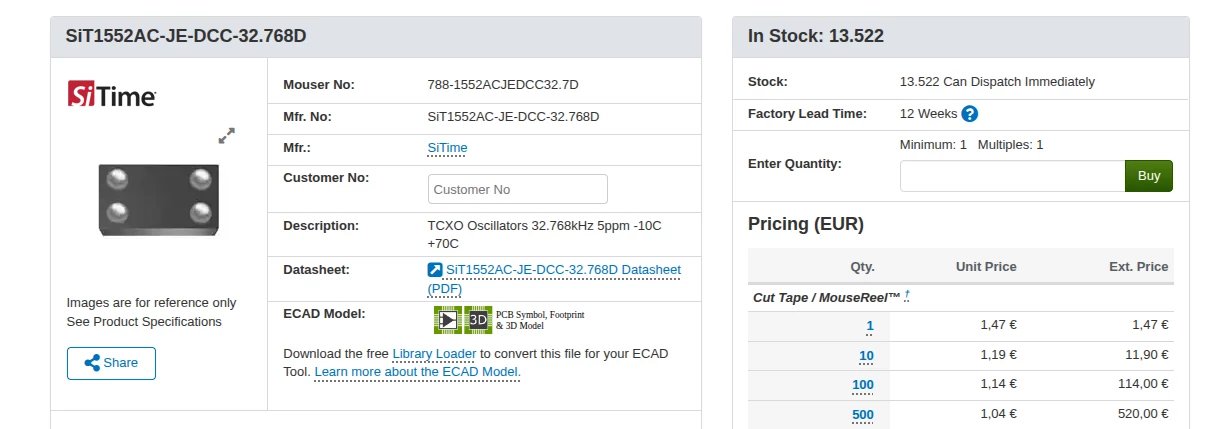

AScha.3
July 9, 2025
or do it "my way" . :)
Forget all this problems and invest 30 ct more than for a crystal and caps : use a low power crystal oscillator.
see mouser...for example :  (mems type osc. here)
~ 1 uA , 5ppm , 1.xx €
even temp compensated!
at 0.8 x 1.5 mm size.
And problem solved.
