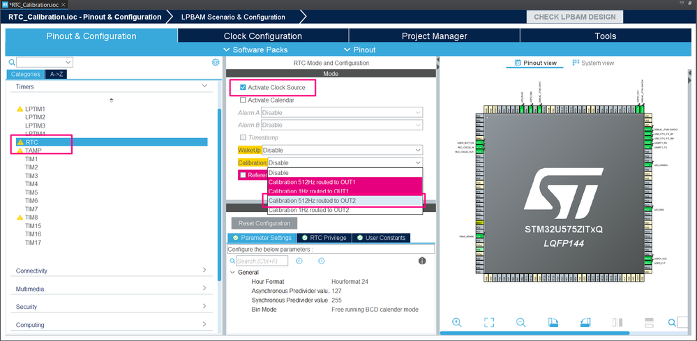

The first step is to enable the RTC and select the calibration configuration 512 Hz. A pin is selected as RTC_OUT_CALIB, in this case PB2.

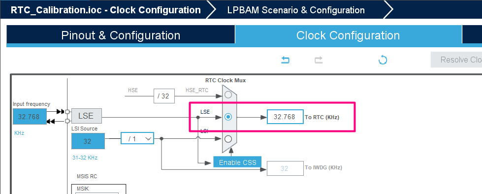

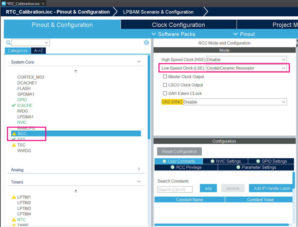

Also, it is recommended to enable the Low-Speed Clock (LSE) Crystal/Ceramic resonator, which is a highly accurate clock source commonly used to drive the RTC for clock/calendar or other timing functions. Be aware that the default selection is the LSI (Low-speed Internal) oscillator, which is not ideal for RTC applications due to its high PPM.
The figure below shows the step to enable the LSE and to verify if it is configured as the RTC clock source in the [Clock Configuration] tab.
These are all the needed steps. Now, you can generate the code by clicking [Project] → [Generate Code].

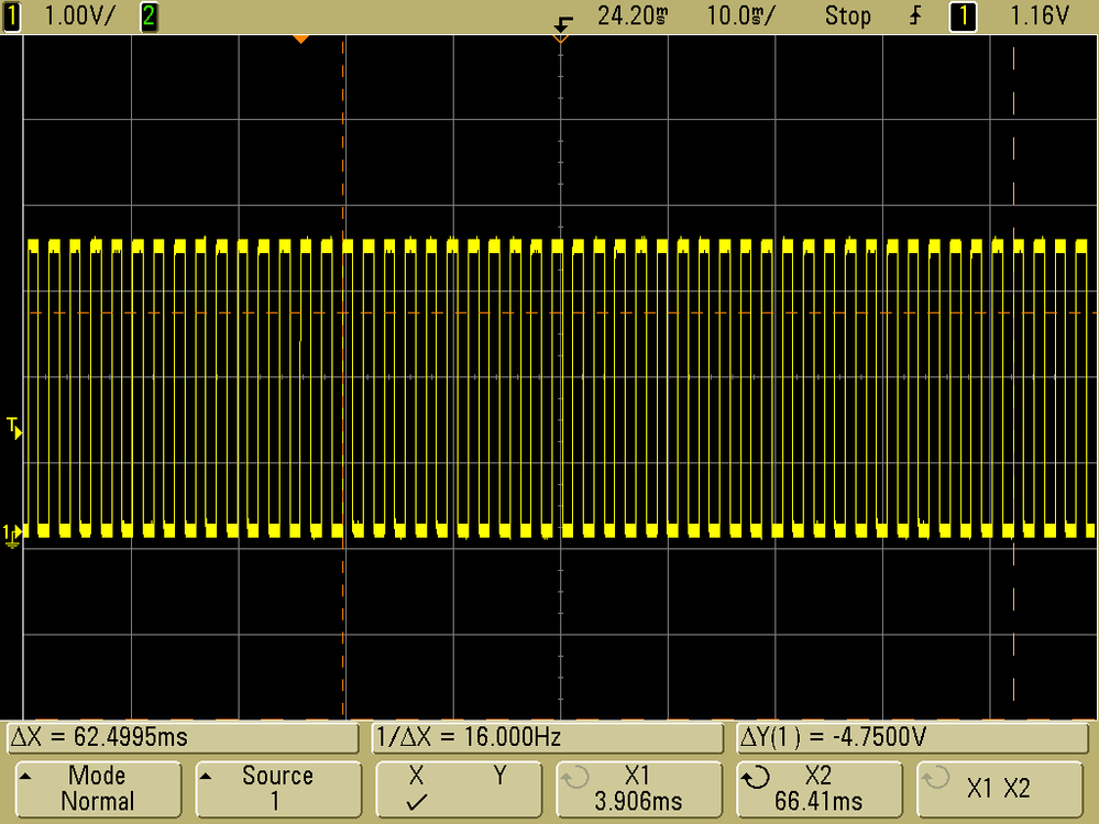

Build by pressing (CTRL+B) and program your STM32 microcontroller by clicking [Run] → [OK]. Now, by connecting an oscilloscope to the referred RTC_OUT_CALIB pin, you should obtain a wave with approximately 512Hz, 32768 divided by 64, like the illustration below:
The next step is to extract the current frequency from the RTC. The measurement period used for the calibration should be equal to the current calibration cycle update period, which is 32 as default. While there are several means to do this measurement, the article relies on the scope to acquire the needed time samples.
Given the default settings, the time to be sample should be at least a 32-wave interval, since we will start by using the calibration as 32.

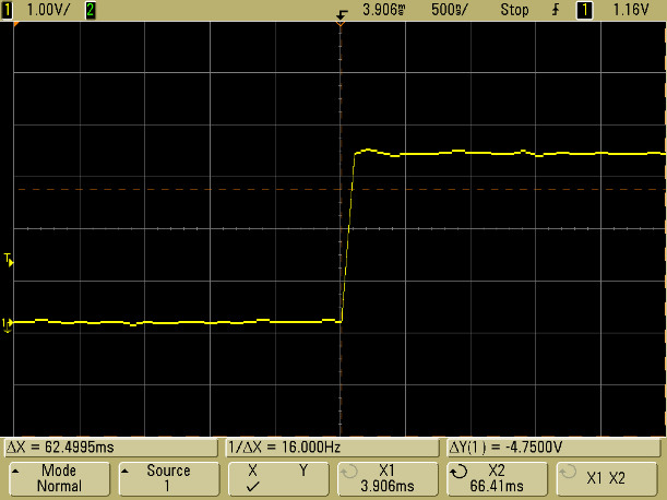

If using a scope, align the cursor as precisely as possible with one of the edges. This article uses the rising edge from the calibration wave, as shown in the figure below.
This simple formula is used to acquire the average frequency. The 32 is due to the sampling interval used: Frequency = 1 / (period / 32).
As an example, the obtained period from the image above is 62.4995 ms. When applied to the formula the result is 512.004096 Hz, which means the real RTC frequency is this number multiplied by 64, equivalent to 32768.26215 Hz.
With this information, it is now possible to compare this pin output with the expected calibration frequency and obtain the current clock error. The following formula reflects this by calculating the average clock error in PPM: PPM error = ((Average Frequency - 512) / 512) x 106.
Based on the previous frequency, the average error is approximately 8 PPM. With this value, it is possible to adjust the RTC to compensate for the inaccuracies utilizing the registers CALP and CALM.

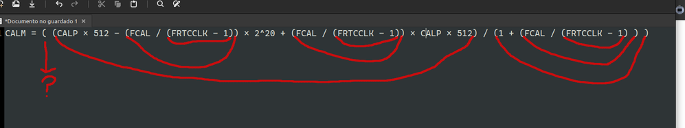

To calculate the correct CALM value, use the formula below, which is the same formula provided in the reference manual, just isolating the CALM. Once calculated, convert the result to a hexadecimal number:
CALM = (CALP * 512 − (FCAL / FRTCCLK − 1) * 220 + (FCAL / FRTCCLK − 1) * CALP * 512) / (1 + (FCAL / FRTCCLK − 1)).

512.004096 * 64 = 32768.20972?
(FCAL / (FRTCCLK − 1))?
CALM = CALP*512 - 220 * (1 - FRTCCLK/FCAL)
XR.1
Senior
January 6, 2025
Hi!
Parenthesis do not match:
B.Montanari
January 9, 2025
Hi @XR.1 and @Alizmay , thanks for the feedback,I really appreciate it! I just fixed the article and re-submitted, it should be updated with the fixes shortly
