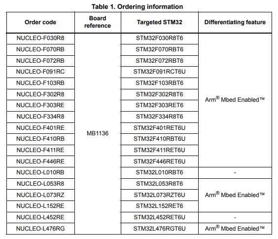

Hi @Community member​ ,
I don't think that the "U" suffix is specific only for the STM32G4 Discovery board.
Look at UM1724: STM32 Nucleo-64 boards (MB1136), we have following table with several devices having U suffix:
In the datasheet, suffixes other than "TR" are described as "programmed parts".
-Amel

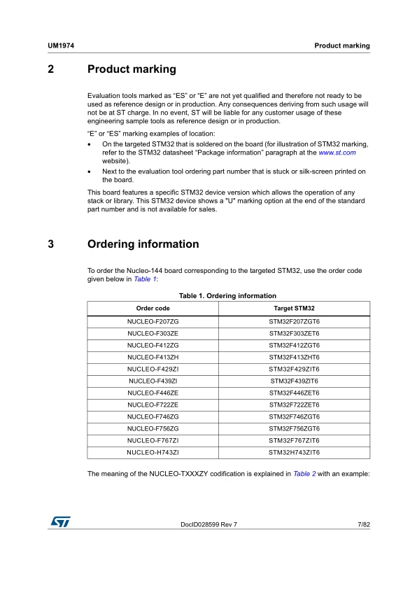

March 10, 2020
https://community.st.com/s/question/0D53W000000YqdISAS/stm32f20xxx-ordering-reference
Interestingly enough, the current UM1974 rev.7 has no mention of STM32F207ZGT6U .
@Amel NASRI​

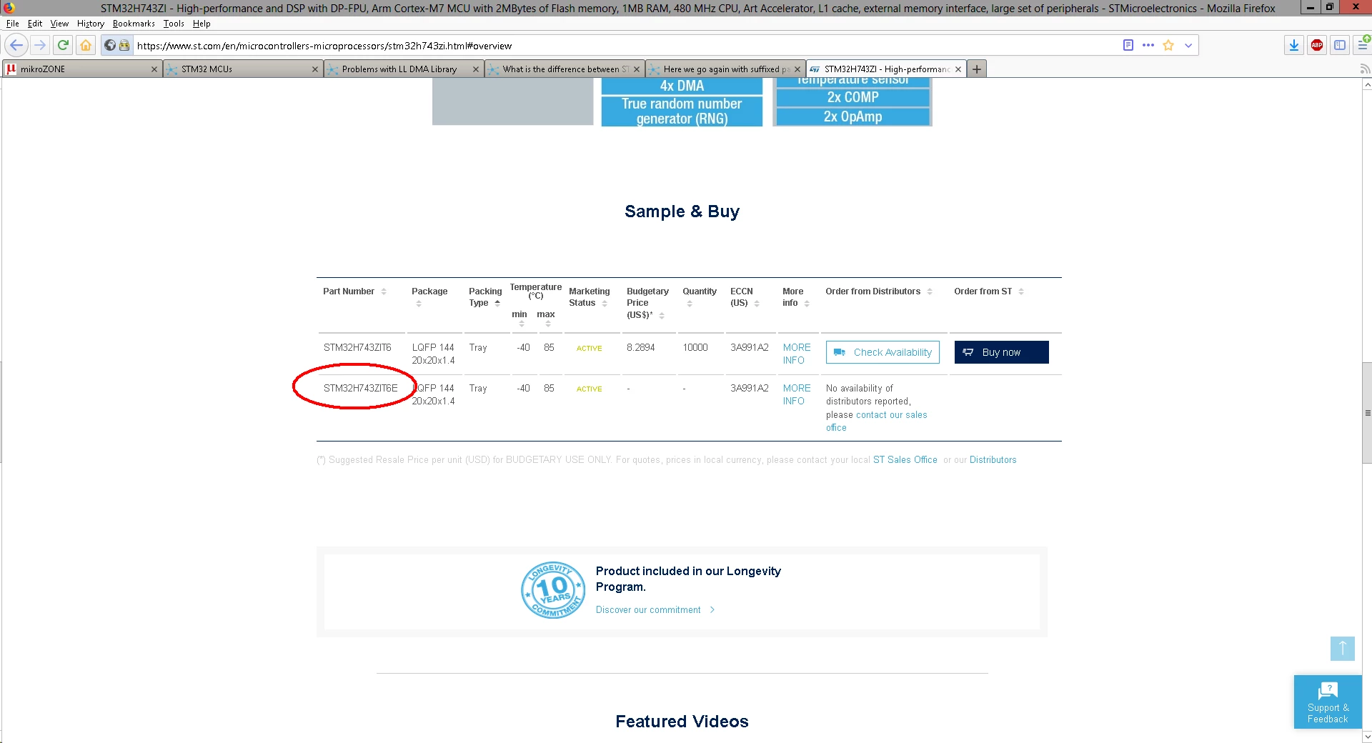

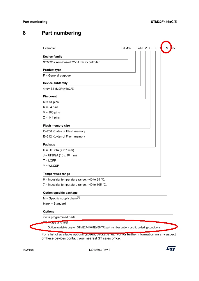

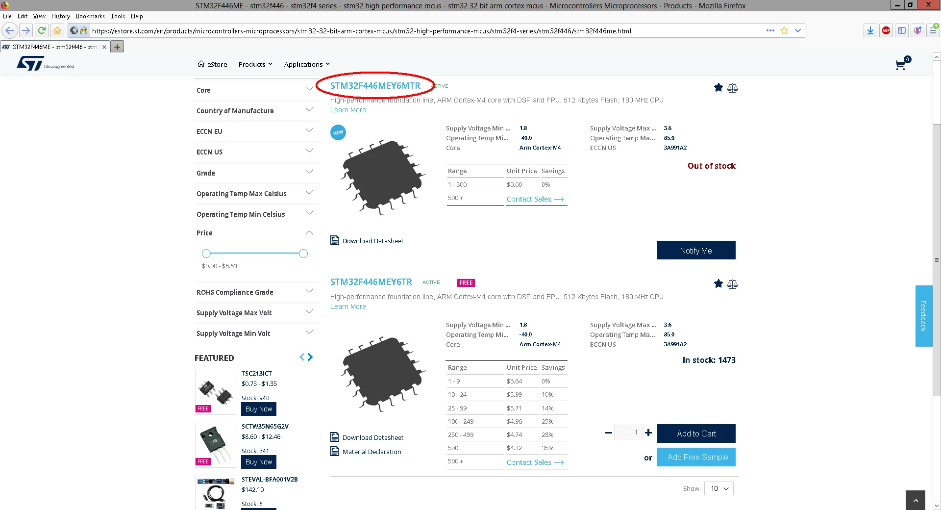

September 3, 2020
M suffix, the description could not be more weird, "specific supply chain"...
Even more weirdly, it *is* present as a separate part directly in the respective webfolder's "sample&buy":
Btw., what's the point of providing a "boilerplate" picture which has no material connection with the real product? (MEY is WLCSP81)? Isn't ST's web ridiculous enough with its overtly active javascriptoids?
ST, you know what would be really attractive to us? If you'd provide *real photos* of *each and every* product, as they are in real life. No kidding.
Uwe Bonnes
Chief
September 4, 2020
The ST page you show does not imply availability in my eyes.
waclawek.jan
September 4, 2020
Well, then you have to source it from some non-specific supply chain, I guess... ;)
