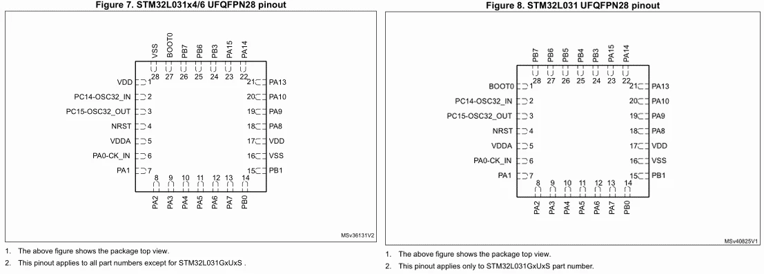

D suffix in 'L0 meaning "BOR disabled".
(specifically in 'L05x and 'L07x)
S suffix in 'L031 in QFN28 means "different pinout from the non-S suffix", but it also means "the same pinout as 'L011 and 'F031 in QFN28". Nice.
