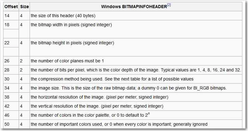

    offset 18  size = 4 bytes,
    the bitmap width in pixels (signed integer) but in code : it's offset 12, or I'm wrong ?
     xx = *((uint32_t *)&hdr[0x12]); // X pixels (want multiple of 8)
    do you mean the LCD ? it's SSD1289, and it's RGB..
    I can see from the file the value of offset 12 until 15 are 40 01 00 00 which mean 320...that's correct but from wiki it's saying at offset 18, so it's not right....

    my mistake, 0x12 HEX = 18 DEC....
    so I will base on :

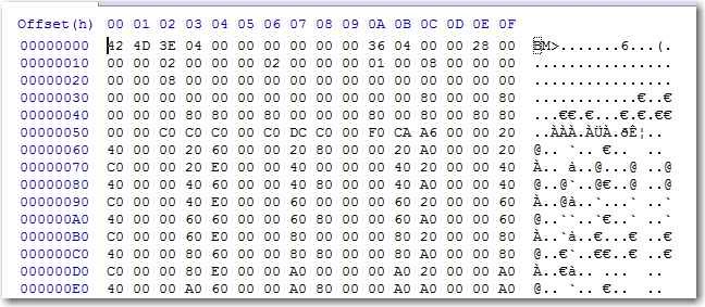

    I have 2x2 pixel 8 bit bmp,
    where is the first byte of the pixel ?
    offset 0x12 = 2 (width ) offset 0x16 = 2 (height), offset 0x1C = 8 bit ( color of 8 bit ), index color is starting from offset 0x3E = 00 ?
    the picture (zoomed 200x) the actual size is 2x2 pixel:

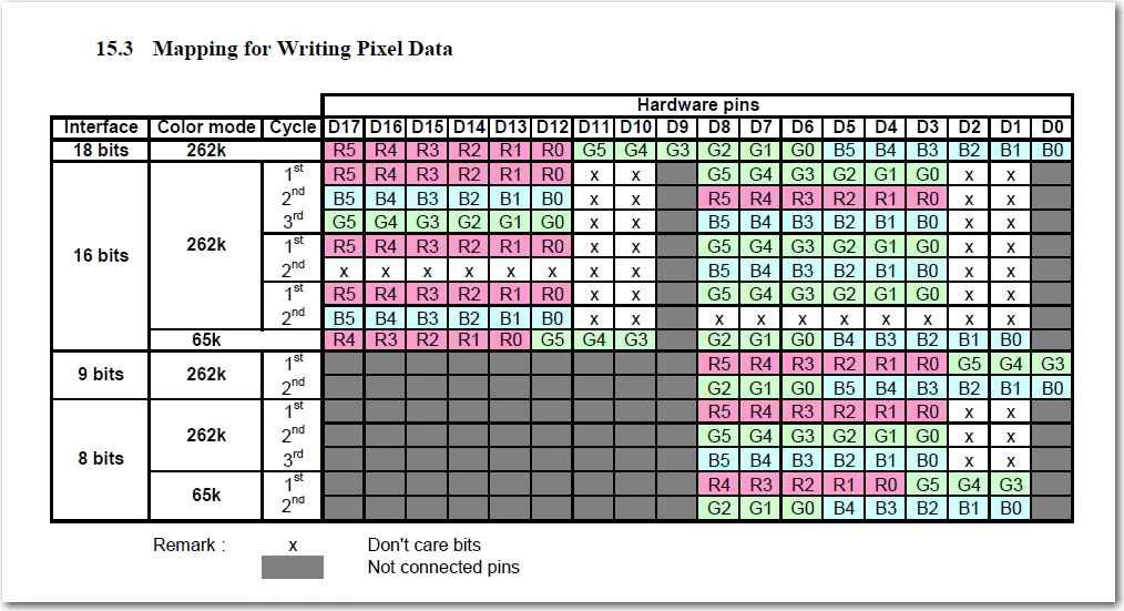

    Ok, please have a look for the datasheet attached...thanks

    is it the one you look after ?

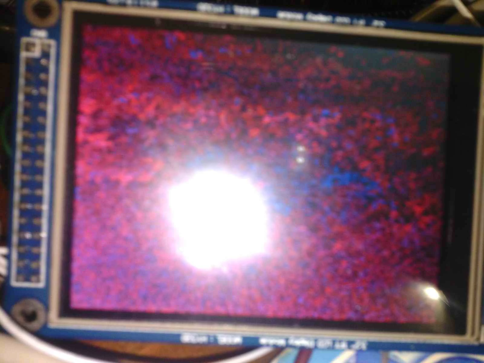

    I tried
    and on LCD :
    What should I change on pal ?

    Ok, I have the manual for the SSD part, do you have any manual/documentation/schematics for the BOARD you are using?
    Can you see and image of the flowers, but with the wrong colours? I can't make out anything through the flash glare.
    Perhaps you have some #defines for RED, GREEN or BLUE colours passed to the functions you are using? Or a cite to the library/code?
