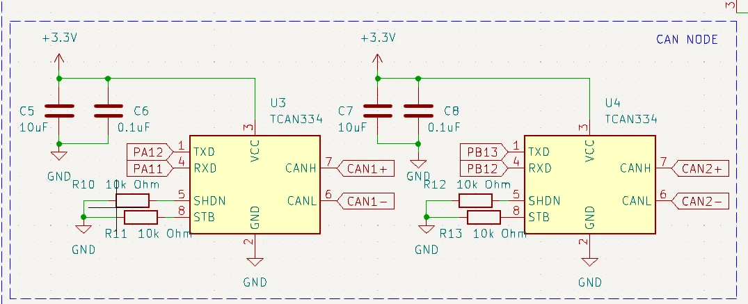

i tested each can bus by using 2 nucleo boards (with the same code) to communicate through CANBUS. Each board connects to the shield. There are two CAN Transceivers on there. In the while loop, they both send the message to each other, read the received message, and then print it out through UART2. The CAN1 works correctly but CAN2 does not.
mƎALLEm
Sep 11, 2024 9:15 AM UTC
Yes but need to provide more details about the HW.
Is is the same transceiver used for CAN1 and CAN2?
Need to provide more details to have full picture to help you efficiently.

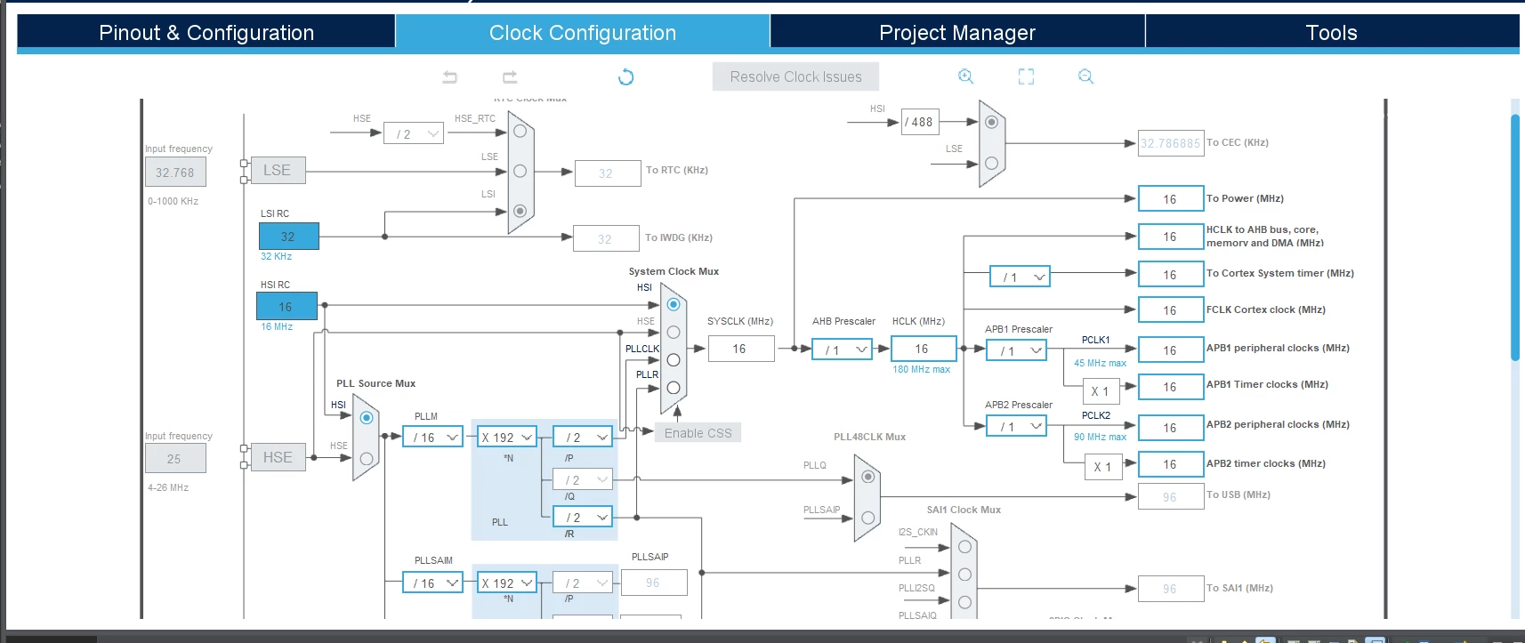

Sep 11, 2024 9:26 AM UTC
here are my transceiver circuits on the shield.
And here is my clock configuration, I use HSI as a clock source.

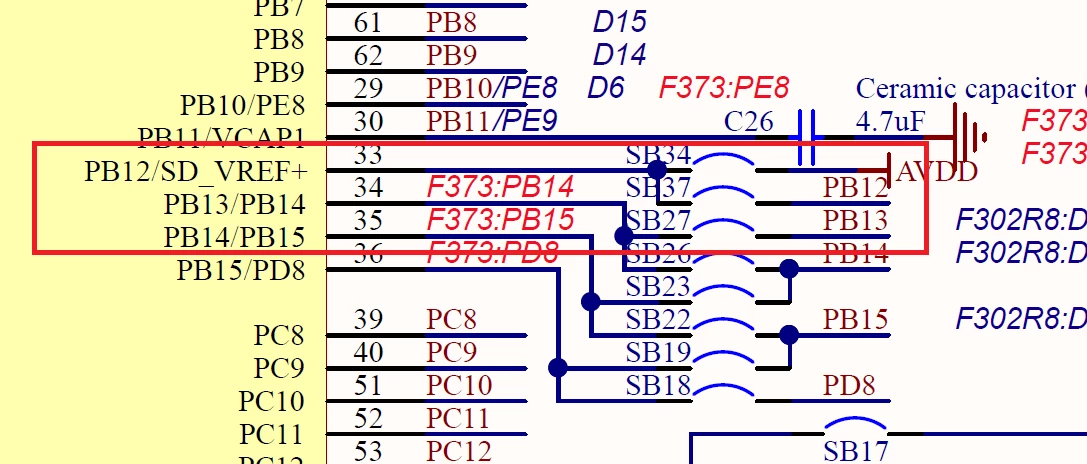

Could you please change the CAN2_Rx/Tx pins from PB12/PB13 to respectively PB5/PB6.
I have a doubt regarding the solder bridges config:

pawatJoyAuthor
Sep 11, 2024 5:44 PM UTC
After I desoldered the shield connected to the Nucleo board, I found that there was a short circuit on the CAN2 transceiver IC. It works fine now. Thank you for your help, and I apologize for wasting your time.
