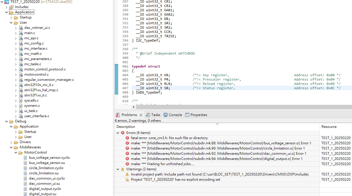

MCSDK5.4.8 motorcontrol reference pack not found
系統 : Windeows 10 22H2
應用 : MCSDK5.4.8 CubeMax6.13
目標工具鏈 : ST32CubeIDE
固件包版本 : STM32 FW v1.11.3
為什麼在從未修改的範例專案生成代碼時會收到此錯誤?

Hello @walen,
Firstly, as mentioned in st community terms and conditions, the language of the Community is English.
Refer to MC Workbench Release note documentation:
On "V5.4.8 / 30-Nov-2021" chapter, it is mentioned CubeMx version to be used "v6.4.0" and firmware packages versions for each STM32 series.
If you agree with the answer, please accept it by clicking on 'Best answer'.Best regards.GMA

Hi Dear All,
Based on the suggestions, what is the meaning and reason for the following situation?
Thank you for the response. Previously used community-specific language. Still learning...
APP: CubeMax6.4 , STM32 FW v1.8.4

Hello @walen;
As the generation has gone up to the main.c file, can you continue with the generated project?

Feb 21, 2025 8:01 AM UTC
Hi GMA,
Yes, the main.c is shown in the project, but as depicted, the compilation failed.now?

GMA
Feb 21, 2025 1:58 PM UTC
Hello @walen,
B13/B14/B15 are shown in gray on "Control Stage" window, so they are not used.

Feb 24, 2025 8:55 AM UTC
Dear GMA,
Could the issues I mentioned be because I didn't open CubeMX before opening SDK 5.4.8? Since CubeMX 6.13 is a later version than CubeMX 6.4, are there any solutions? My company requires IT personnel for installations and uninstalls.
